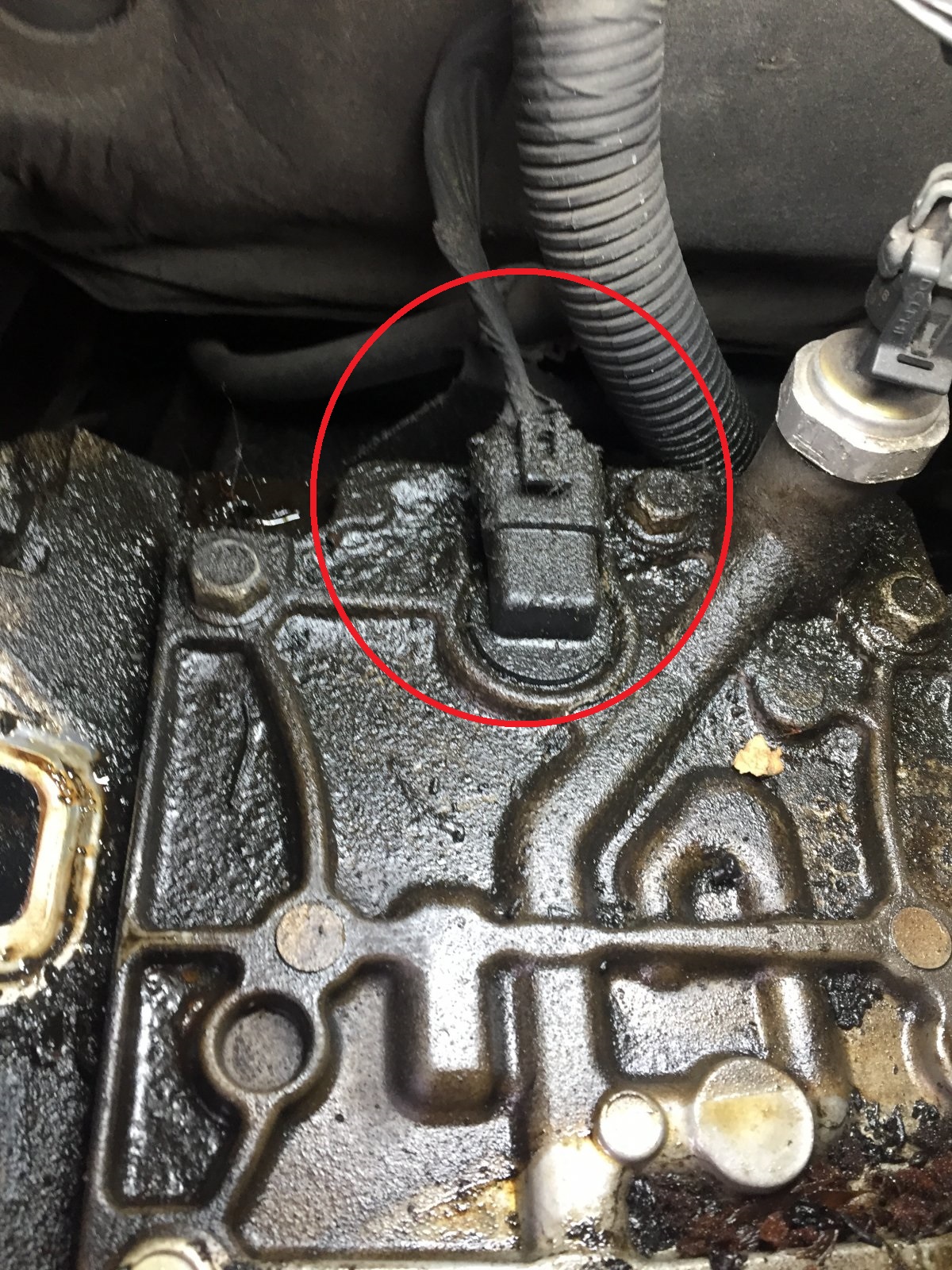

It would have been almost impossible to knock the VLOM plug loose -its your first
picture, although that WOULD cause a check engine light.

I'm wondering if he could have possibly knocked this plug loose?
Or this is damaged?
Or this guy?
Thanks for the pics and ideas.
Mine is an 07 6.2, so no VLOM. One thing I can rule out at least. The other lines I have replaced with new and as far as I can tell are OK.
My strongest doubts lie with the brake booster vacuum line and its connection in the intake manifold. Unfortunately that means the whole intake manifold needs to come off for fault diagnosis.
