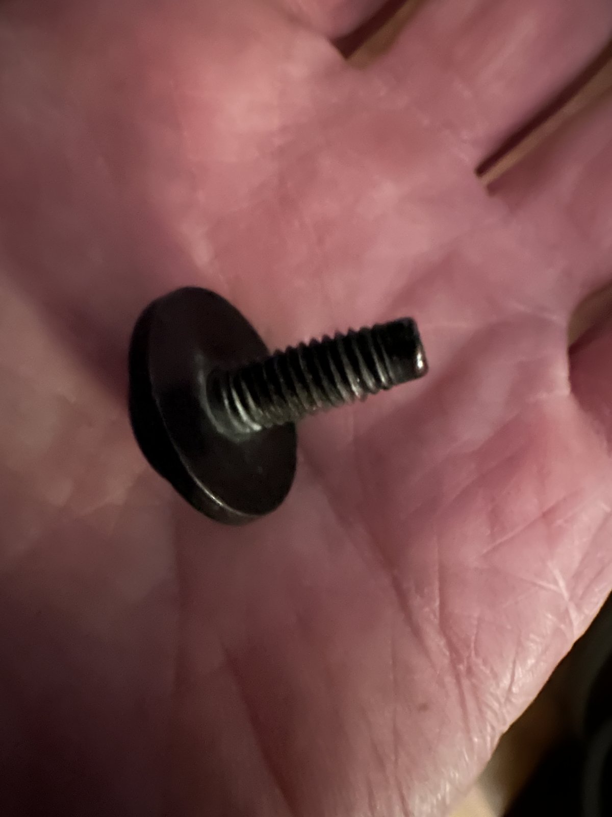

The owner of the company I work for had a rattle and found a completely fallen out bolt with the remaining bolts loose on the panel that holds the rear glass in place. He just happened to open the glass instead of the hatch and saw something fall out....
