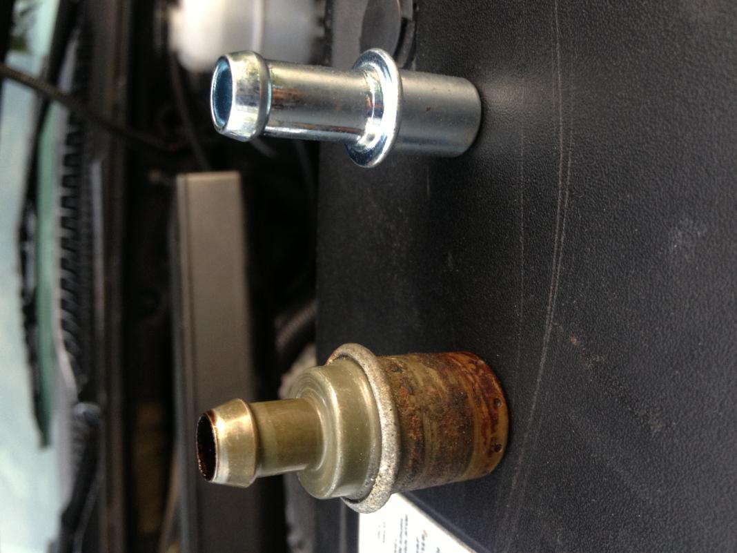

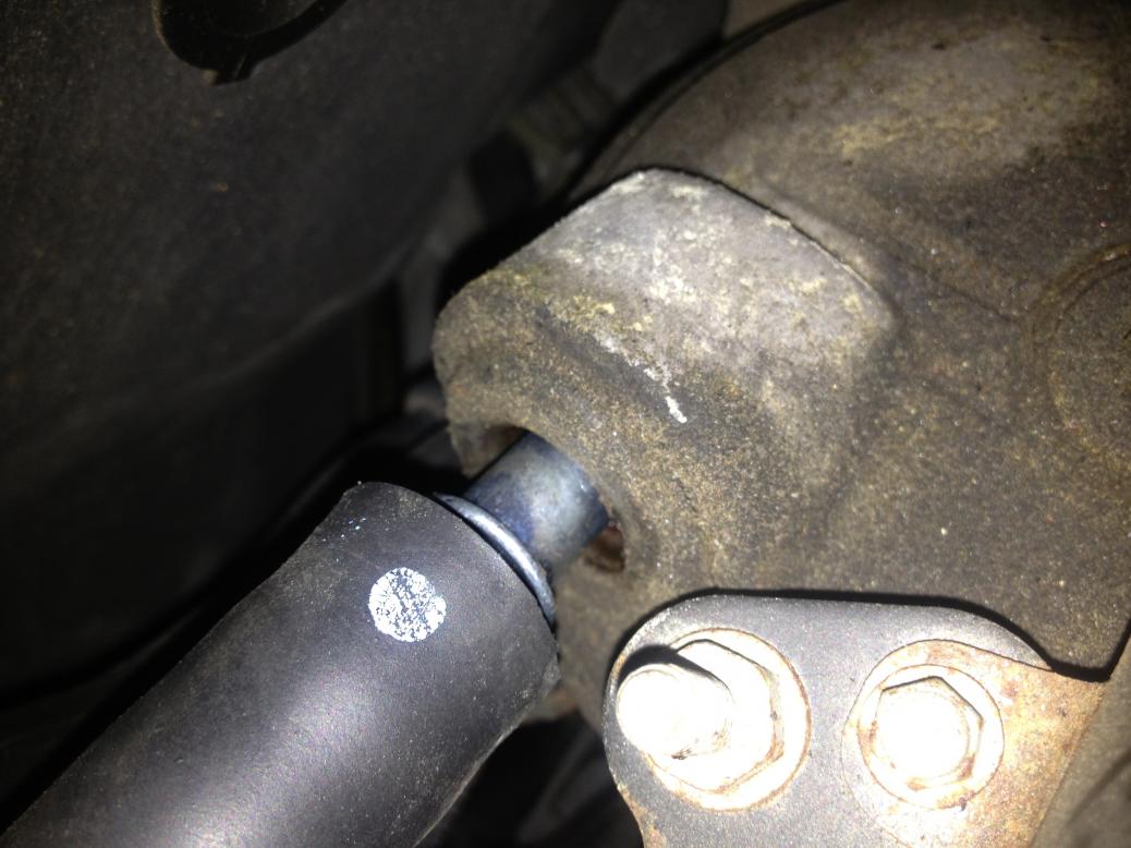

I just got the updated PCV valve and it doesnt fit. Help please

where did you get the PCV? Id go back to them and get the right one.

I got at my local Chevy dealer. Does anyone have the serial numbers for this part?

I just called on one actually. The manual in my glovebox for my 2002 with 5.3 says CV948C but the guy on the phone said I needed part# 12576460 which is the hose and PCV together.
From the looks on google/amazon CV948C looks like the old one you posted.

You are looking for part number cv4000c. Its 6.40 on amazon and one of the reviewers on the product said he had the same problem as you and the valve fixed it and also smoothed out his idle. Looks like the dealer gave you the wrong part. The old style that came on your truck is a spring loaded pcv valve while the updated one is called a "fixed orrifice pcv valve". After enough people starting complaining about there tahoes escalades silverados ect were having trouble with oil seeping past the spring loaded valve, they updated the part in 2004 to fix the issue.

My Tahoe user manual states CV948C for 2002. The manual doesn't state anything for Flex from what I can see. WHen I looked online at rockauto and many other sites they reference Cv4000C for Flex fuels on 2002 and regular or flex for 2003. I don't know what the difference is, that's why I am curious.
I do know the CV948C looks like the original posters PVC that he pulled.
CV4000C - 12572717
CV948C - 25179136
The only visual diff I can see so far is the CV948C is brownish color and the CV4000C is shiney/polished
Ok..found this on another site. The one you reference is a newer style (better) with the out the checkvalve.
