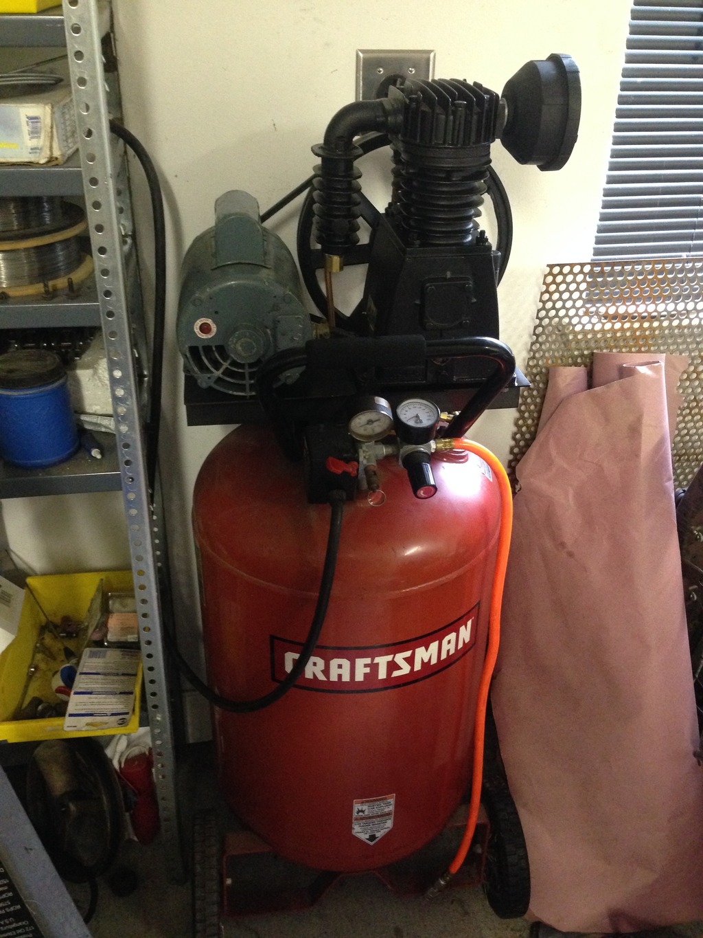

Bonus/pertinent story: I came home one day and the circuit that oil-less Craftsman was on had a tripped breaker. I reset it and it immediately tripped as long as the compressor was plugged in. After inspecting it, my guess is that it had a slow leak and would kick on intermittently, but the pressure switch failed and it didn't shut off at it's set pressure and burned itself up. Other than that, the tank was in mint condition so I bought a 110V motor off CL, a twin cylinder compressor from Harbor Freight (solid units for the money!), some copper tubing and fittings from Home Depot and Frankenstein'ed it into a much better compressor for the garage. I could've used a 220V motor, but I already had a 220V compressor for the shop so I wanted to have a portable 110V unit for the garage that could be taken somewhere if needed:
