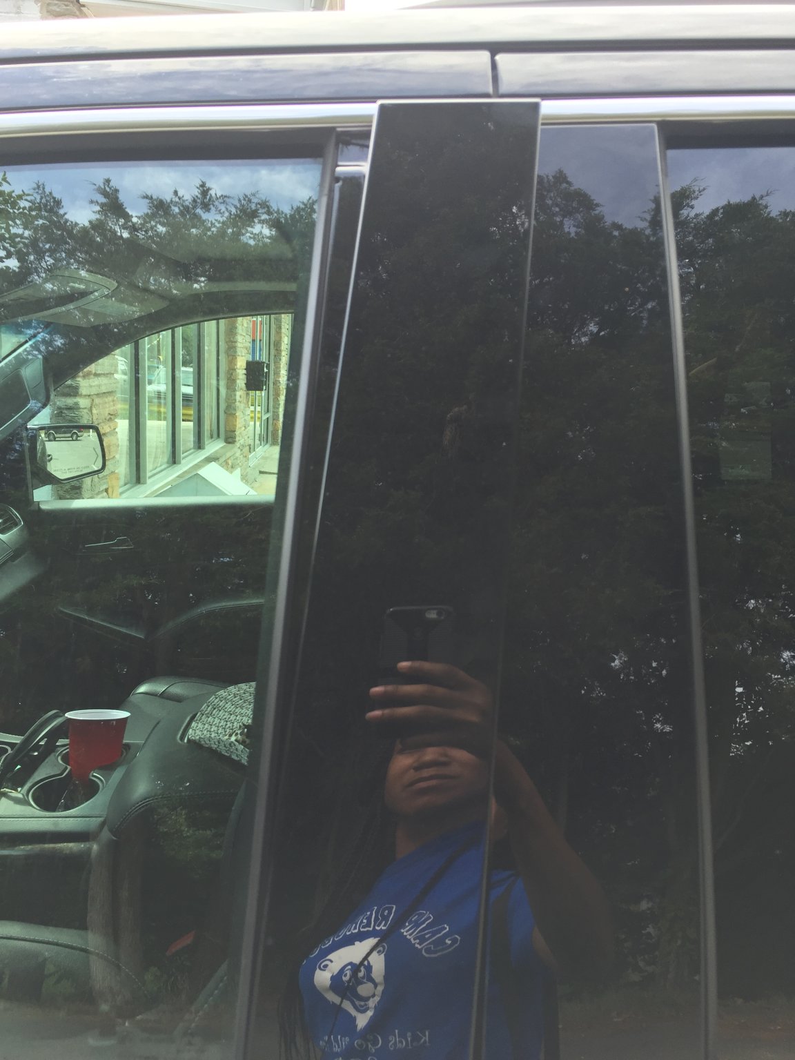

I just noticed mine starting to fall off yesterday. Heard a flapping sound at 75 MPH and sure enough, I looked in the mirror and they were flapping away. The Gloss Black trim pieces that cover the door pillar on the outside. Stopped, got out and they move around by hand. They feel like they are going to fall off at any second. I cannot believe it. It wasn't just the one, 3 of them are loose. What a cheap and poor design. $70 Grand and they have tape holding on trim pieces. Guess I will waste my own time at the dealer now because GM doesn't believe in quality. I only have 4,000 miles on this truck, and am starting to regret the purchase. What a shame.:smh:

I just drove from St. Louis, Missouri to Destin Florida going about 75-80 most of the way there. I heard this flapping sound coming from what I thought was the driver side seatbelt fasten on the wall. Never thought about it being something on the outside. Tonight when my sister got out of the backseat and closed the door heard a sound and looked and see 1 of the black plastic trim piece is not clipped on the top and doesn't line up the same anymore. I'm on vacation for 1 week and then are driving back to Missouri. It's about a 12 hour drive and don't want the piece to totally fall off when driving. Does anyone have a temporary fix to get me back home. Not sure if electric tap that's black would work. Still mad at GM for this poor quality. $74,000 for a Yukon XL Denali and plastic trim falls off after 27,000 miles on the car.
