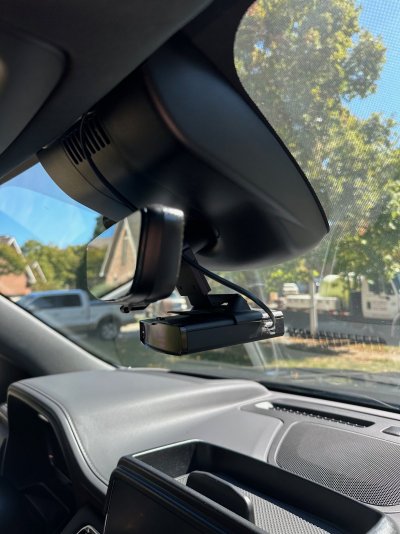

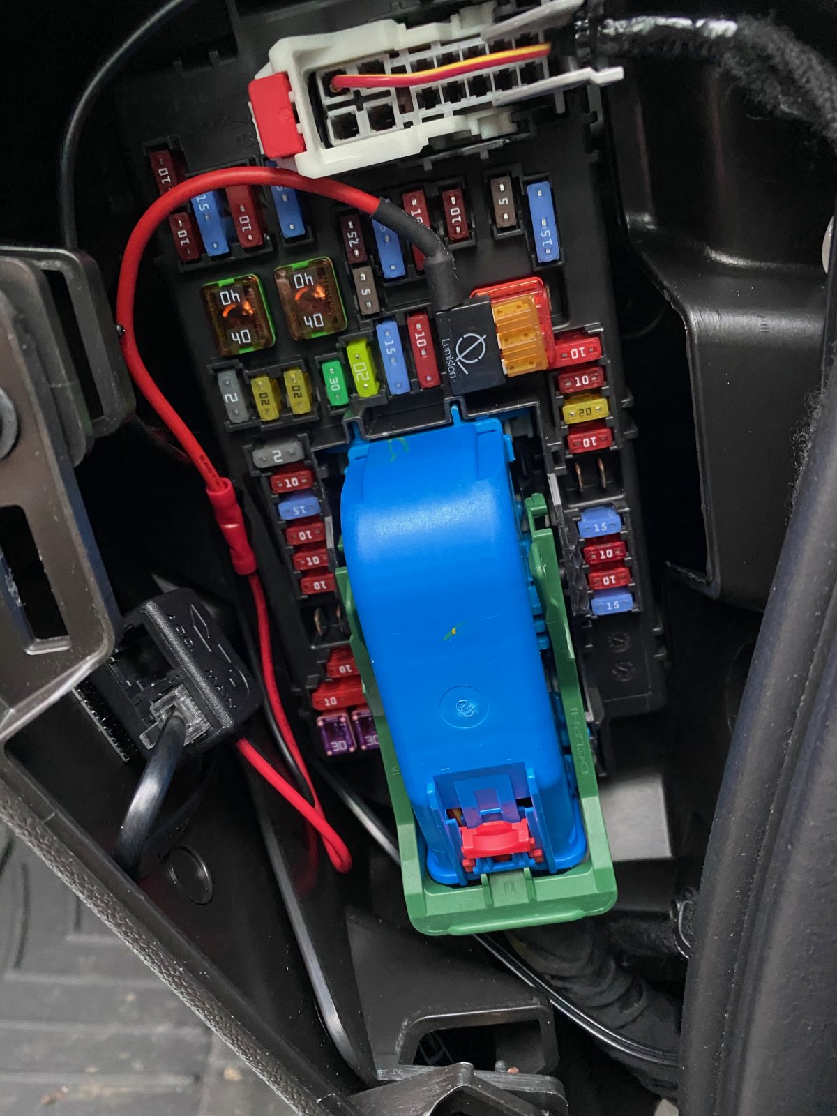

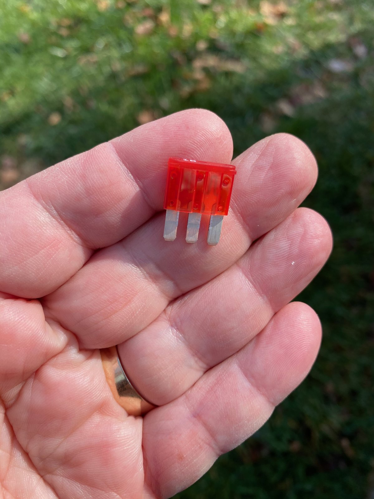

i have a 2023 tahoe... the fuse panel on these trucks is in the end of the passenger side dash... run the wire up the "A" pillar and under the leading edge of the headliner. you can use an "add a fuse" to get power.. please note these trucks have a new "3 pronged" fuse. i used a "blendmount" brand bracket and attached my detector to the rearview mirror.62888186408__6CE31358-5DE8-4330-BEA6-A433ADA59DE1.jpegIMG_3027.jpeg

i have a 2023 tahoe... the fuse panel on these trucks is in the end of the passenger side dash... run the wire up the "A" pillar and under the leading edge of the headliner. you can use an "add a fuse" to get power.. please note these trucks have a new "3 pronged" fuse. i used a "blendmount" brand bracket and attached my detector to the rearview mirror.View attachment 410207View attachment 410205

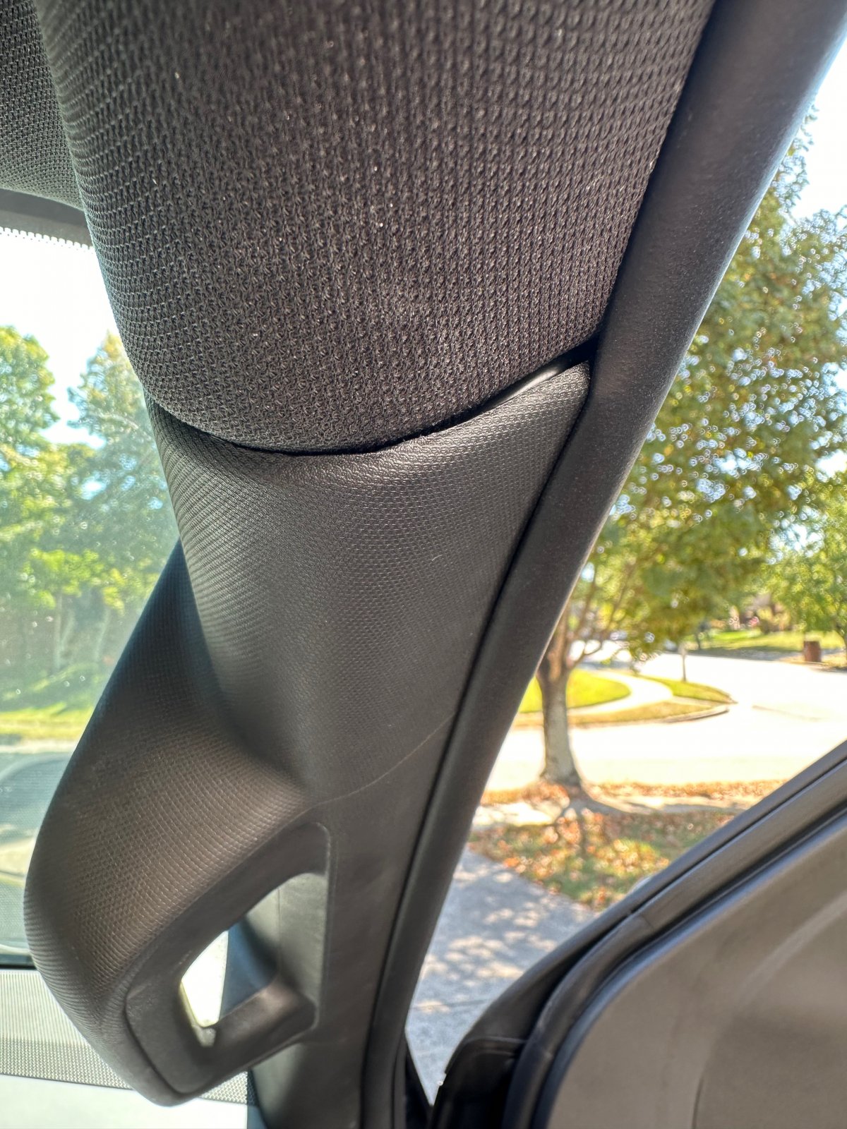

i put the wire under the flexable black rubber from the dash up the a pillar.. then i took a plastic trim tool and slightly opened the gap around the top of the hard plastic a pillar trim so i could get the wire hidden behind. after that i got the wire under the leading edge of the head liner.20230923 - 1.jpeg20230923 - 2.jpeg20230923 - 3.jpeg20230923 - 4.jpeg20230923 - 5.jpeg
