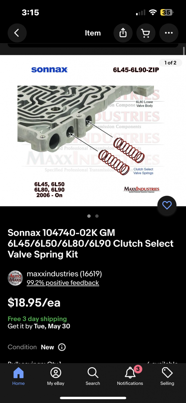

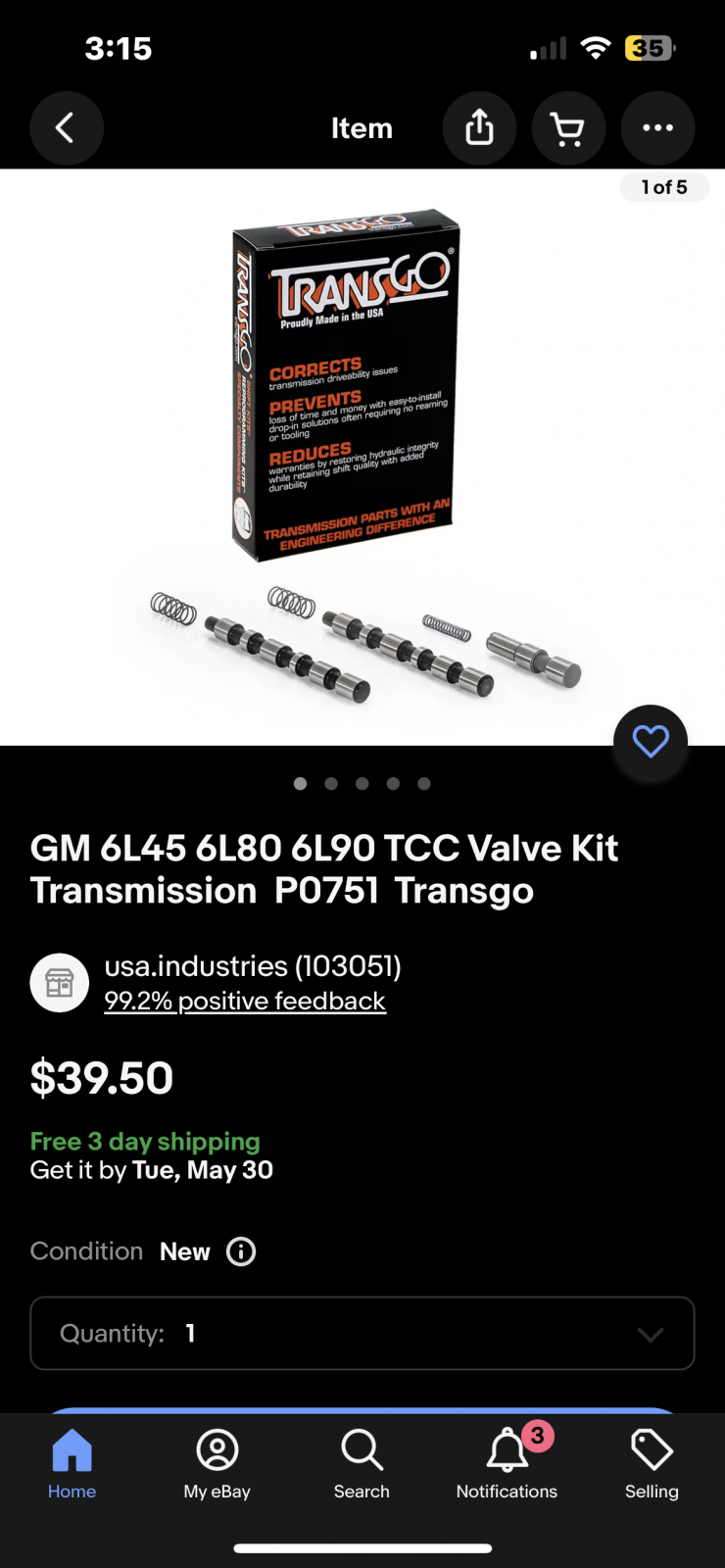

i do know that the clutch select valve springs / bore plugs / of the like can be an issue here. i have been considering getting the sonnax clutch valve select spring kit .

being as how the shifts are improving as they are with the fluid - i assume it’s probably a wise choice to go ahead with the sonnax clutch spring kit anyway? couldn’t hurt. that’s in the plans for next week. even with the improvements i think cause the trans is old as it is with 300k on it.

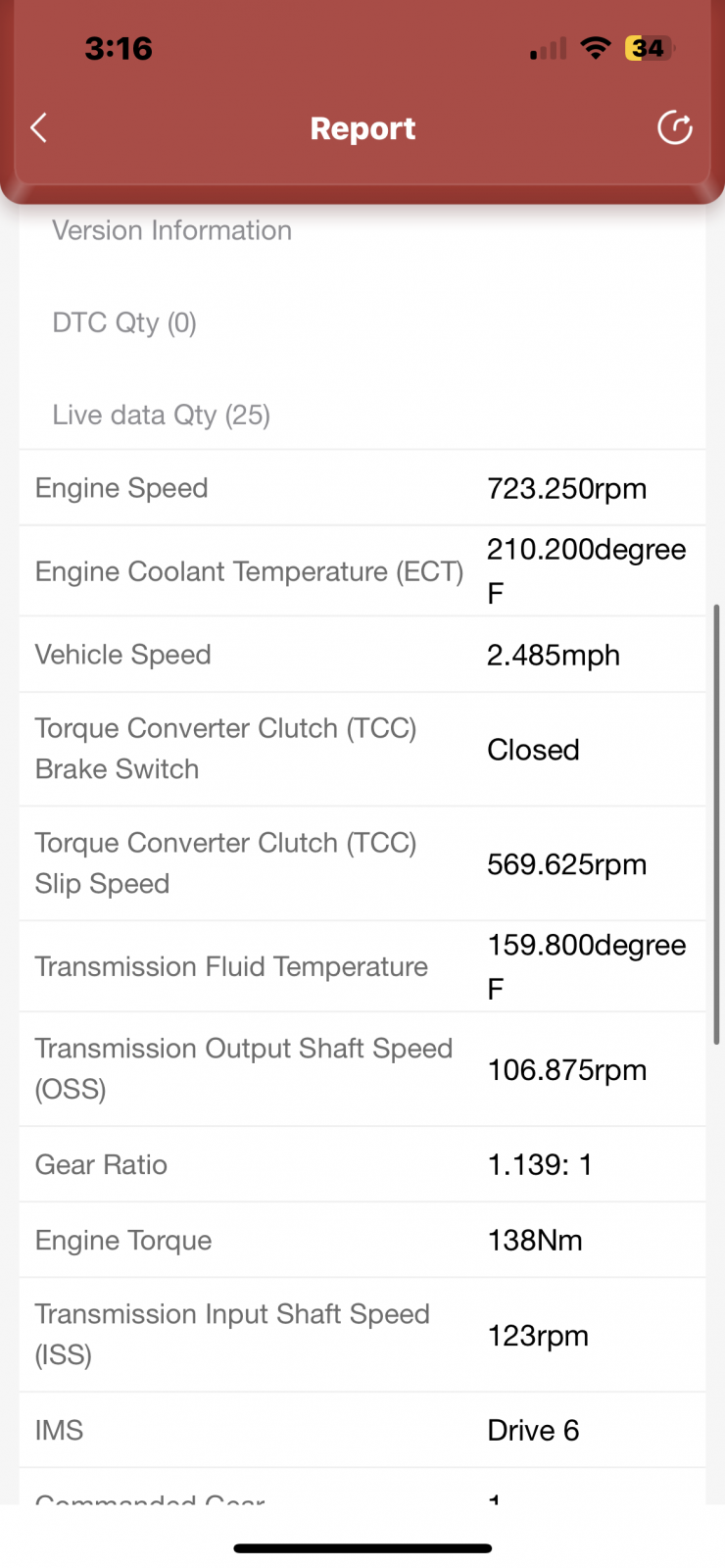

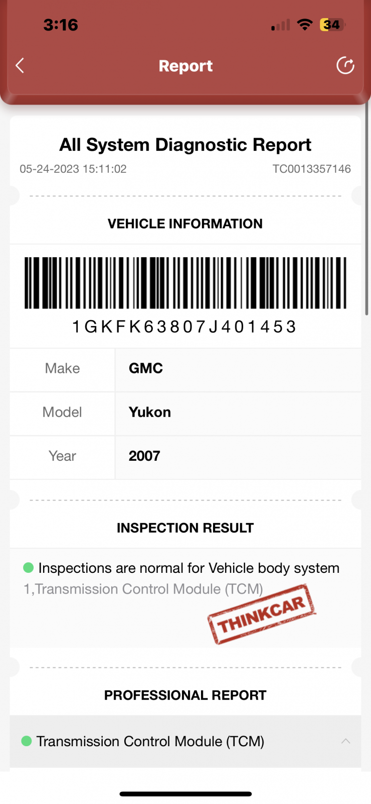

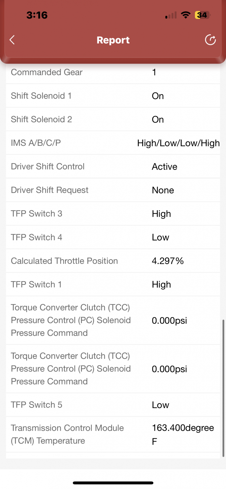

here’s the screenshot of the freeze frame
i was getting back to you with my year & model. i did not do the clutch select kit or springs. from your posts i’m grasping it would still be a wise choice. i have the spring kit in my cart on ebay

yes sorry i was responding to you lol you beat me to it.
Yep, do them and the compensator feed regulator valve kit from Sonnax (bumpy, jerky shifts are the result when that valve wears out).

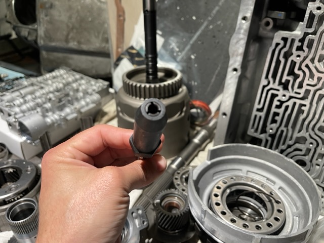

Lastly, replace your parking rod assembly if/when you work on the valve body again - the rivet on the end likes to fail and the "bullet" separates from the rod itself and you cant put the vehicle in park anymore. GM didnt fully update the design until 2018 so i always replace when overhauling these units.
You will need a special tool, Kent Moore DT-48550 (collet-style roll pin puller) or an equivalent tool.
