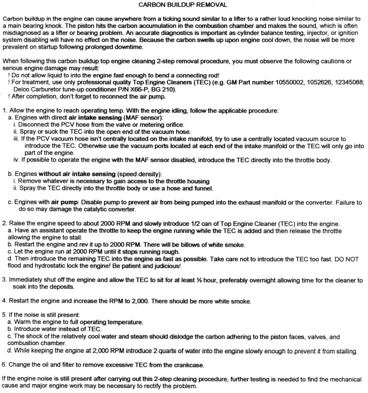

"Piston slap" usually describes pistons slapping the sides of the cylinders.
I would call this carbon knock, when the carbon builds up on the top of the piston and head, and the piston--> carbon <--head all touch ever so slightly causing noise.
When I worked for Mazda, the 929 had a recall on this. I tore down one of the first engines in 93-94.
