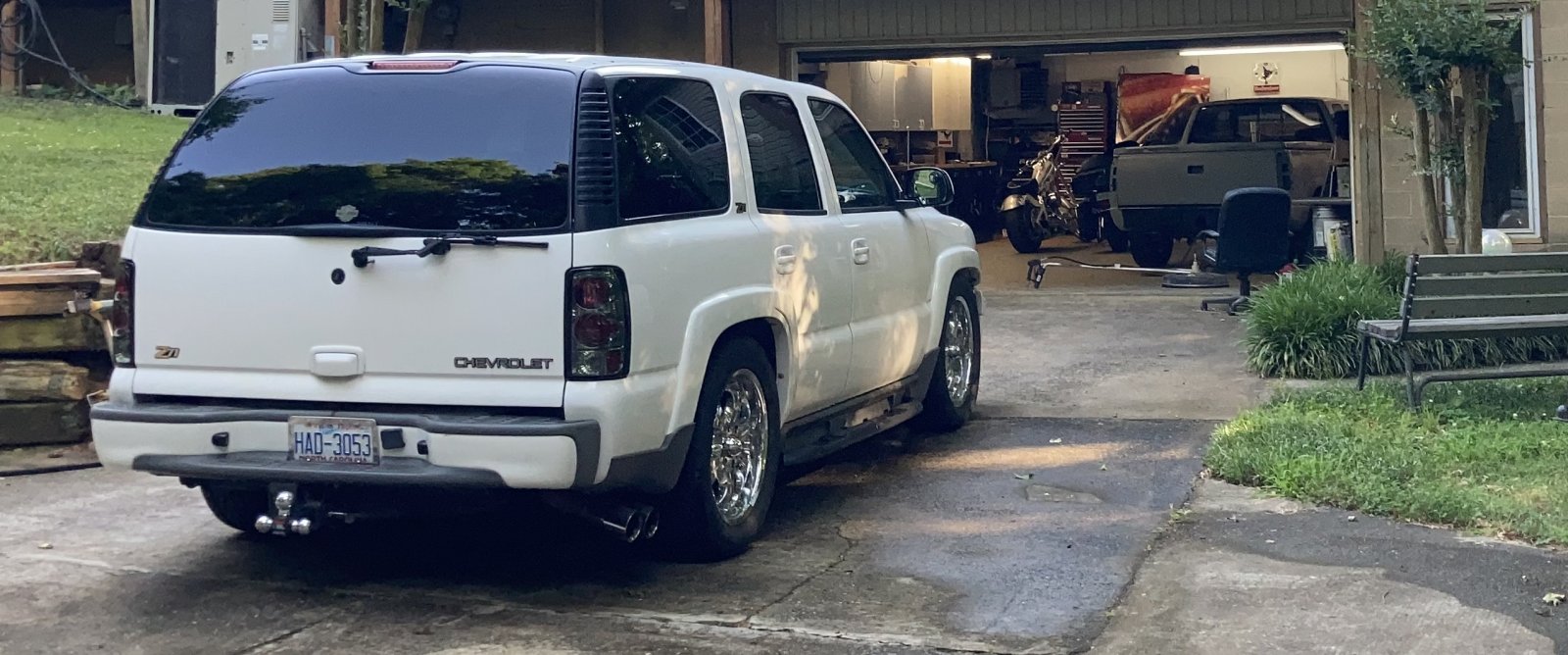

Getting my rear lower on 2004 Yukon SLT
lowkon_kelo
Jan 1, 2025
i just got my yukon lowered and the front looks really good but it just seems like the back isn’t as low as i want it. I got a 4-5/6 drop. it looks level but it just doesn’t look low enough. any help?

A little more info please. How was the back lowered? How long ago was it done? How much lower did you want it? Do you still have the same wheel/tire combo? Did the ‘04 come with auto leveling?

Are there no shorter rear springs for these trucks?
I think some guys on the Silverados will just cut down the coil springs to lower the fronts:
I wonder if you can do the same to the rear coils on these trucks?
6 inch drop springs Springs, drop shocks, free travel mod. was done about a month ago. I do still have the same wheel tire combo but have some 275/45/20 i’m about to put on. And i’m not 100% sure about auto leveling but i’m pretty sure no.

Yeah yours does sit a bit higher in the rear. Did you do all the factory relocation brackets?
