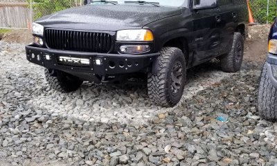

Woah, that looks sweet. Where did you find that bumper? And how much of the front end did you change from original when you rebuilt it, if any? I have been searching everywhere for a front bumper change because the stock denali bumper drags on everything when I am off-roading.
Thanks dude its coming together. I got the bumper from Bumpersonly.com , it was made for a 99-07 Silverado 1500 so I had to cut off the bumper mounts and replace with the appropriate mounts. Other than the grille and bumper everything else is stock.
Here's the links for the bumper and mounts.
https://www.bumperonly.com/products/lex-offroad-csaf1-chevy-silverado-1500
