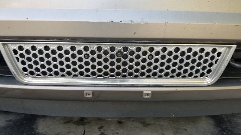

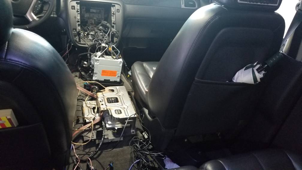

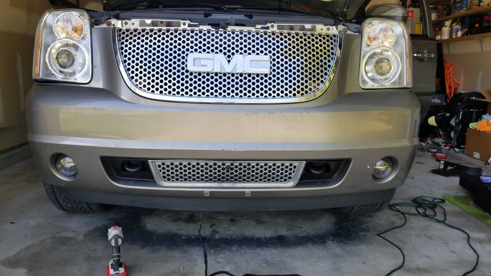

Hooked up to aftermarket head unit? Can this be done with the stock system/screen?

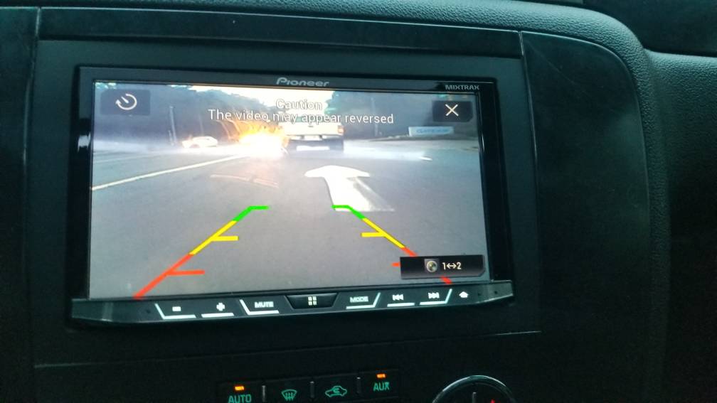

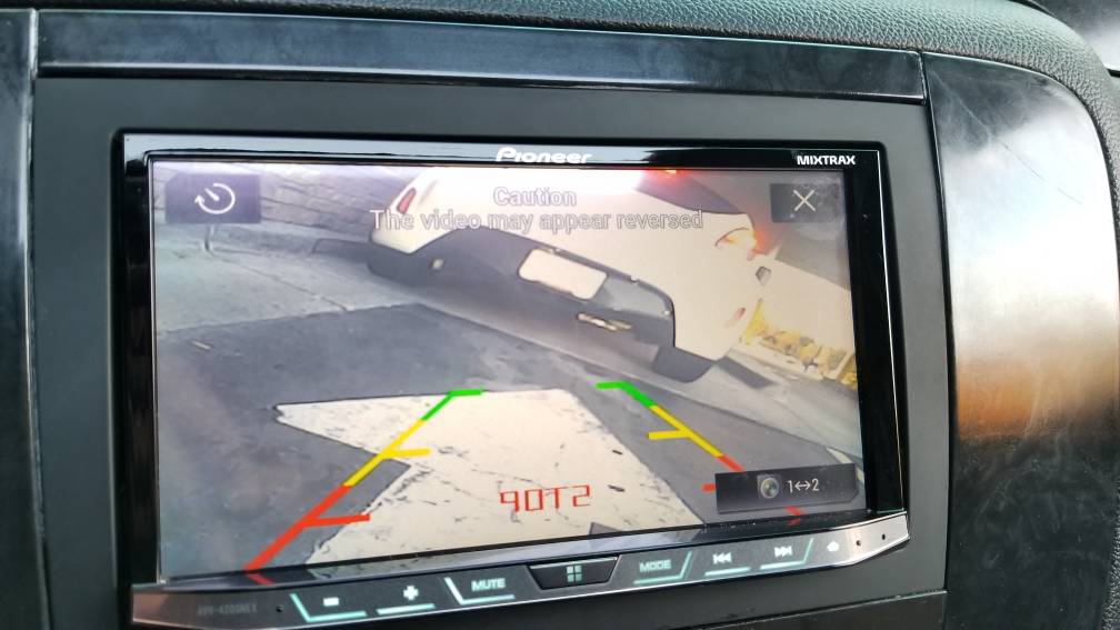

Hooked up to a Pioneer 4200NEX.
If you get the gm passlock, you probably can through the AV input.
On the 4200, it's through the av input, but it has an option to modify the av input to be used for a 2nd camera input. The camera is hooked to constant power so I can select the front camera view at any time, except when in reverse.

And not for the secondary camera. I have the main backup camera in the brown input which is activated when putin reverse. If I had constant power to the backup camera, I could view that one as well. The secondary front camera is through the yellow A/V input. Then you switch it in the camera settings to camera so you can activate it in the Camera View menu. I do not think there is any other spot to run another video in on this head unit.
