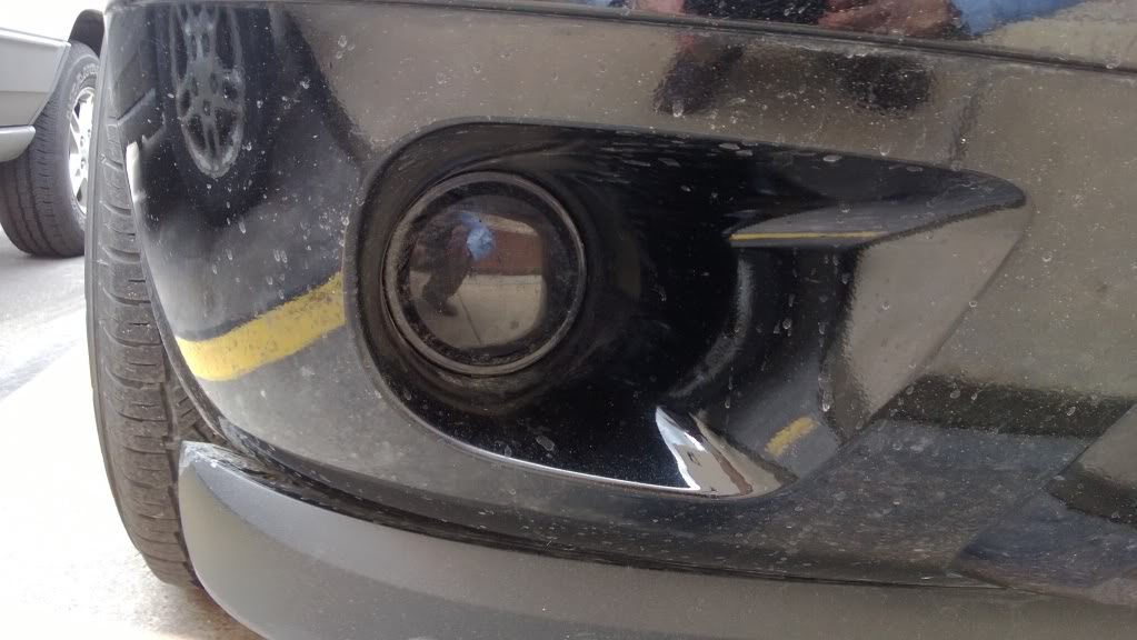

Did you ever get this to work? i have a '14 PPV and ordered the foglight kit. (it was cheaper to buy the whole kit than the two individual lights, as I was originally just going to wire them up myself. Just needed the factory lights.) I then...installed the new headlight switch, took apart the under hood fuse block and inserted the kit pin out to power the lights into the X1 connector (i think), the B5 hole and put it back together, put the lights on the connectors to try it, held the ground on and tried the switch. Nothing. It says not for PPV for a reason. Maybe the switch isn't powered? The appropriate fuse is already in the foglight position (15amp) and the foglight relay is in it's spot as well.
(Just like they say NO TRAILERING, but yet the connector for the trailer wiring is under the bumper so you can hook up the wiring plug when you install the receiver bumper bar.)
Im going to try to run down some wiring diagrams for the headlight switch and the fuse block tomrw.
I talked to my tech at the DLRSHP hoping that the circuit just needs enabled in the computer, he says that is not the case.
I'm hoping I can jump power to the fog light switch on the headlight switch and make it power the factory circuit.
