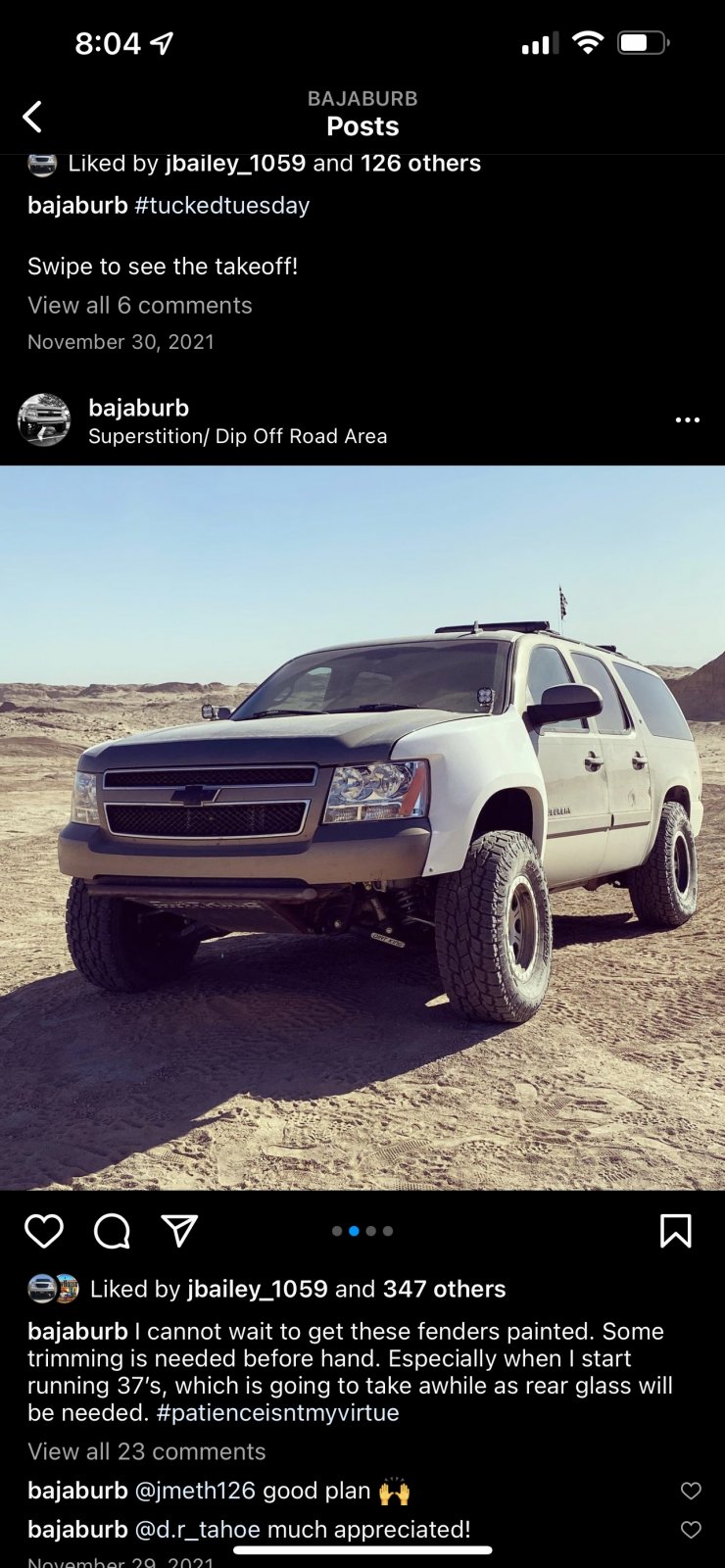

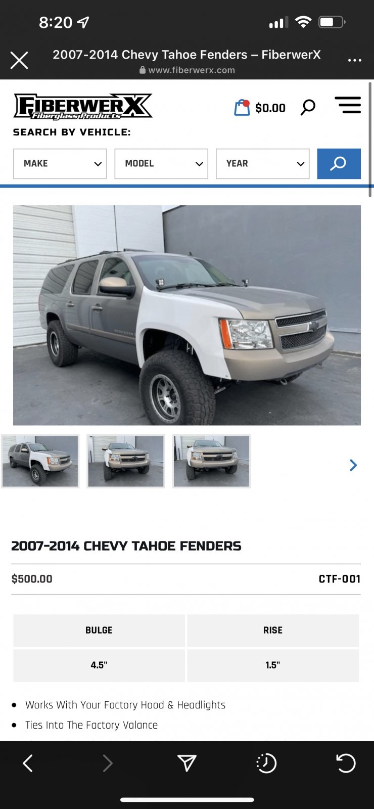

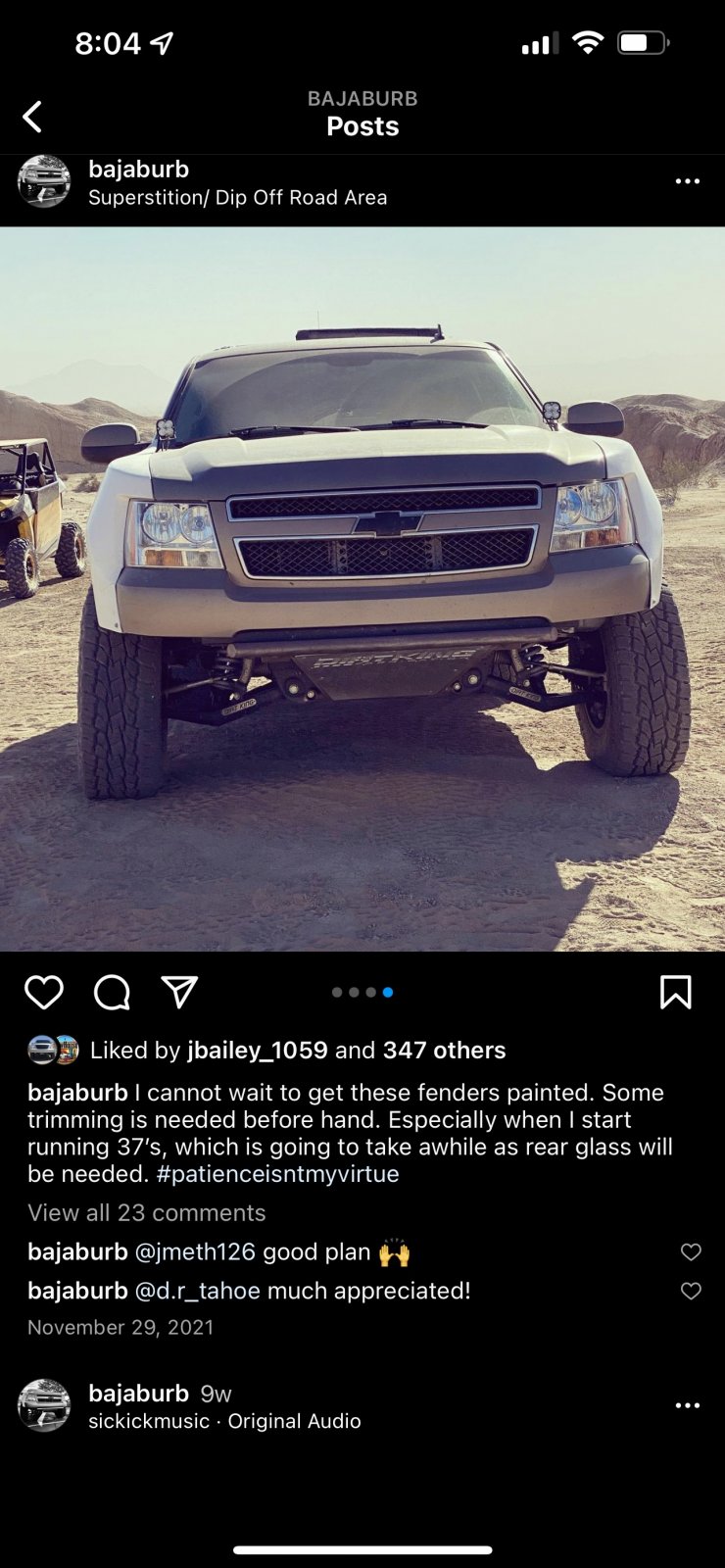

Fiberwerks fenders! This is the kit I’ll be ordering soon

Pretty old, but fiberwerx now makes a tahoe/ suburban front fender and there are several long travel kits out there.
1low had mentioned the fiberwerx fenders earlier in the thread
It's funny to think that there are options now for LT kits.
