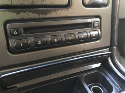

Just to clarify, are you talking about this unit? Or the actual head unit? I will send either, or both but I want to confirm it actually works before you spend money to ship it. I've only had the truck a few days so I don't know yet whether it works or not.

I forgot the Denali has a different stereo system. On mine, the 6 disc is in the head unit. Do you have a picture of the head unit too?
Wondering if I could make that system work in place of my factory Bose system with 6 disc head unit. Thanks again.

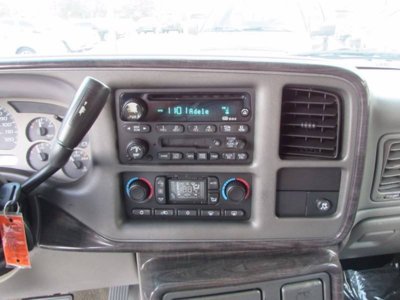

Here's the head unit. It's a little rough. It works for am/fm/sat but I haven't tried the cd or tape, but i can try the cd part tonight..

Well it looks like both of these units are shot and would be a waste of your money to ship them. The head unit is a multi-cd player, but it appears to have cd's stuck inside and just clicks a bunch of times when you hit eject. Nothing will insert at all. The other part does nothing whatsoever, no lights, no nothing. They are slated for the garbage bin...

Thanks for posting the pic. It looks different than mine and I don't want to mess with converting from one style to another. Thanks for the offer. Hope you and "malmed" can work out a deal.
