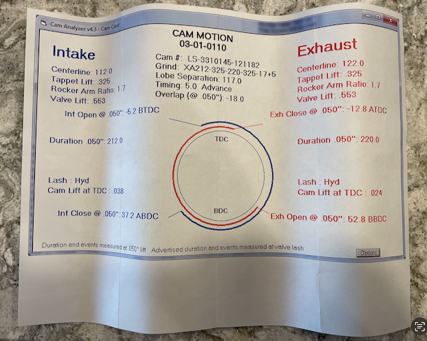

Here's the cam card for the Cam Motion cam that I have and like so much. They make it in a "low lift" version as well but I have BTR springs good for .560 lift, so I went with the higher lift version. The 117 LSA seems to be the key for the smooth idle with this cam. As with yours, the power increase was very noticeable over stock. And I get reminded of it every time I get behind the wheel of our 2007 after driving the 2012. Both engines are Black Bear tuned for 91 octane, but the 2007 still has its stock cam and the 2012 feels like a gorilla by comparison. Slightly more aggressive exhaust sound as well, which affirms your point about the change in sound with your cam.

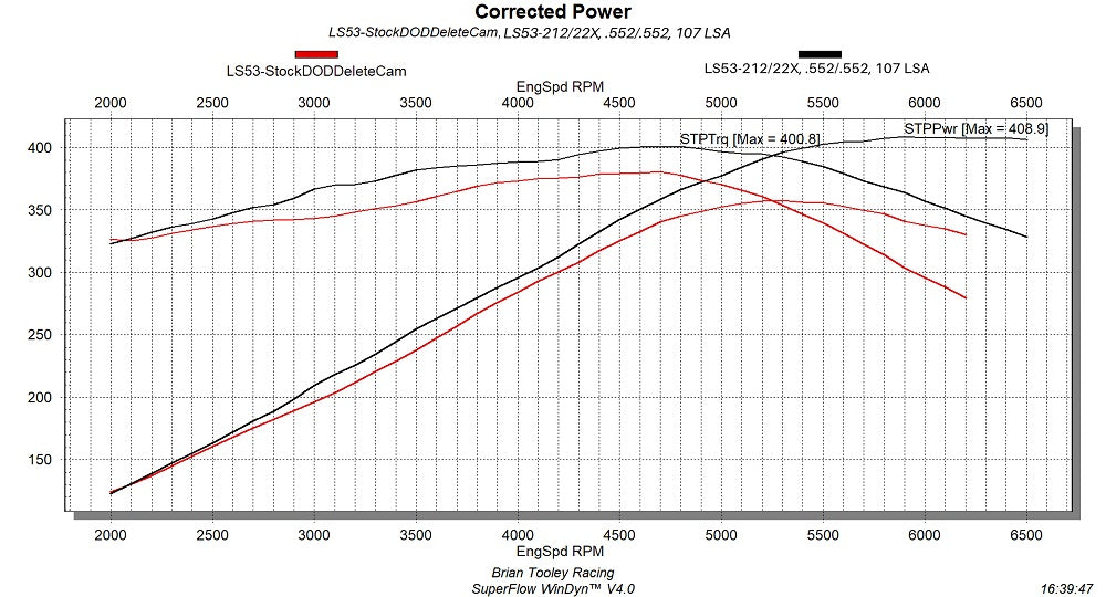

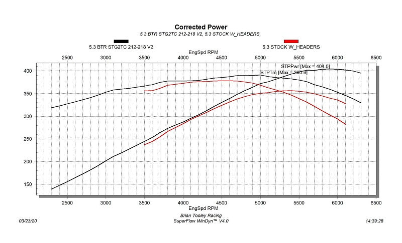

What's the difference between the BTR stage II and the Truck Norris cam?
If you can, do post the specs from each of them here and it will save us each from having to go look them up individually. I’m assuming what you’re interested in is understanding how they each will behave and perform differently? If so, having a bunch of eyes on the specs will give you lots of input.
I ran the BTR stage 2 truck cam for a while and it gave decent power gains but I didn’t like the idle chop at all.

Thanks Charlie, so the BTR stage 2's specs are: 212/218, .553/.553, 111+0 and the Truck Norris's specs are: Specs: 212/22X, .552/.552, 107.
To these, I'll add the specs for the Cam Motion Stage 2 Truck Cam: 206/210, .553/.553, 115+5 "High-Lift" version, for comparison.
What I was interested in was the lobe separation angle (LSA). All of three of these cams will perform better than stock - especially above 4500 RPM. But, with LSA's of 107 for the Truck Norris cam you can expect it to be significantly choppier at idle than the BTR stage 2 cam, which is already pretty choppy. For me, that was an unpleasant experience in a daily driver.
All three have similar valve lift for airflow, and the Truck Norris cam predictably performs best on the high end (as you would expect given the durations) but in my opinion, that's more than offset with worse drivability and minimal, if any, gains from idle through 4500, which is where most of us spend our time driving around.
The Cam Motion cam offers a smooth idle and good power gains that you'll feel on the butt dyno throughout the rev range so in my opinion the drivability and enjoyability for 99% of the driving I do, is much better. And having had both the BTR stage 2 and now the Cam Motion Stage 2, there is no comparison for me. I much prefer the driving experience of the latter. And for me, the Truck Norris was never even a contender given the higher power band and Harley-Davidson-esq idle.
And to further make myself sound like a shill for Cam Motion, they also have grinds for this cam that are specific to the 4.8, 5.3, 6.0 and 6.2, so they optimize it for the flow characteristics of each engine. The BTR cams are one grind fits all.
