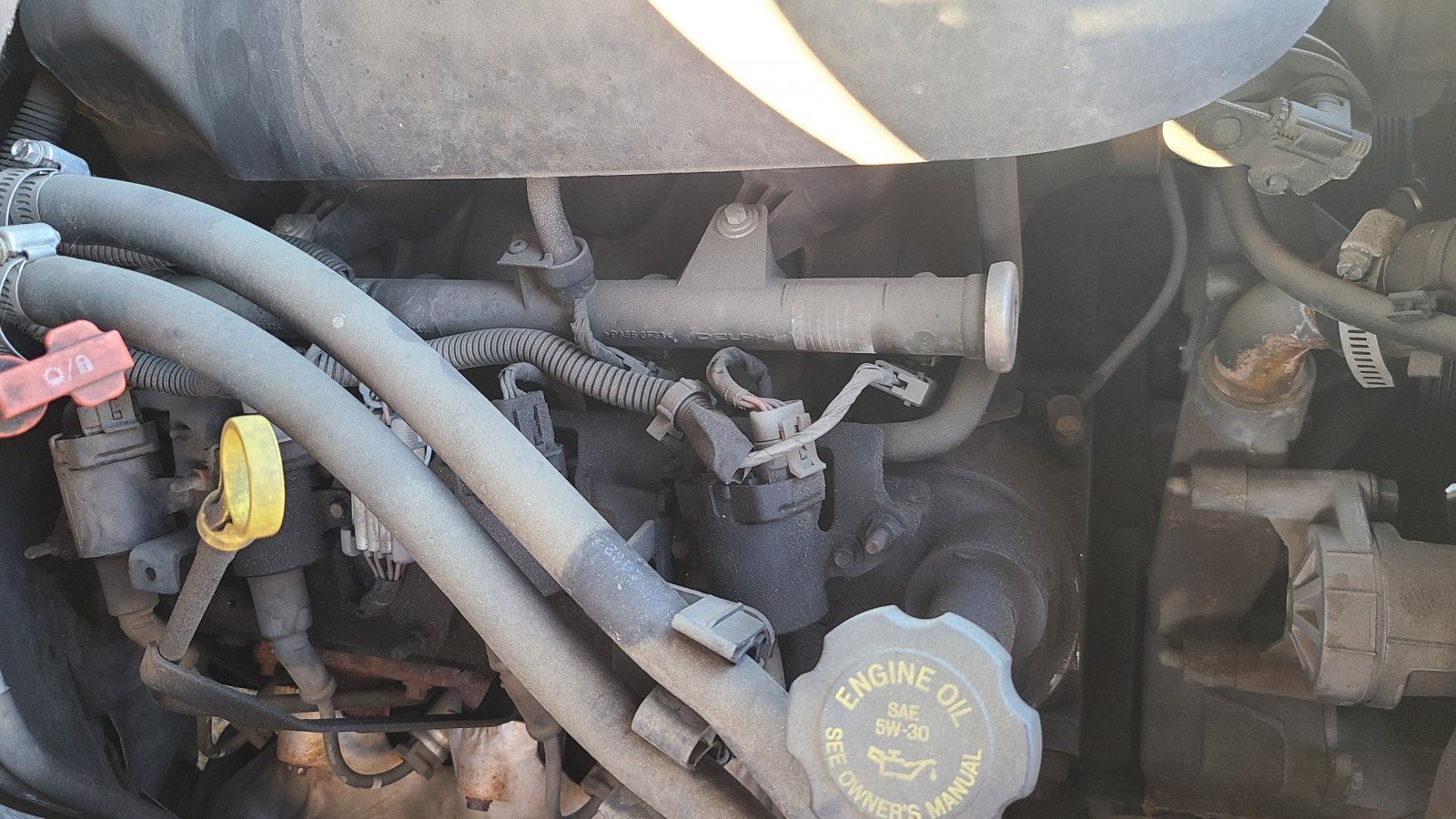

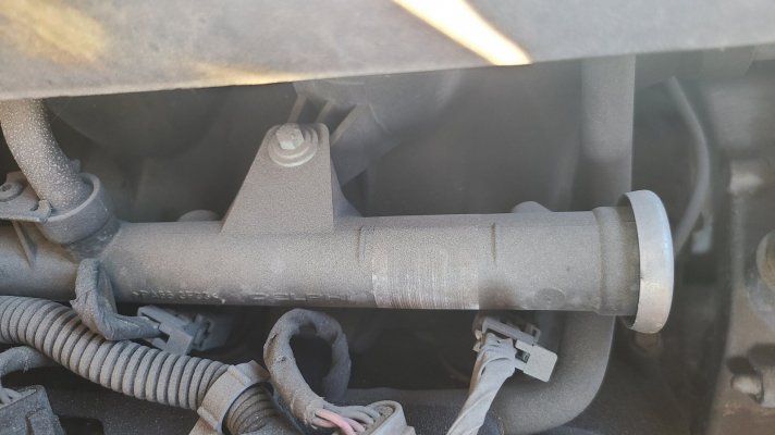

Is your kit supplying you with new fuel injectors? Each fuel injector will have a connector similar to those you illustrated. These are the injector connectors and location on my '02 Tahoe Z71, LM7 (gas) engine, sitting "under" that horizontal fuel rail. I am no E-85 expert, but belive you may need to replace (8) fuel injectors, upgrade the fuel pump, and install a Ethanol sensor.
