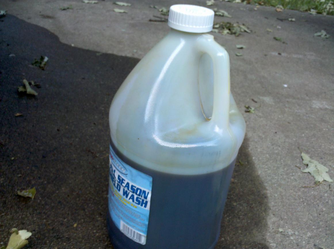

Sucked all the gas out with a little transfer pump, wasn't much in there, but boy is it some nasty, stinkin stuff.
As you can see doesn't look much like gas.
