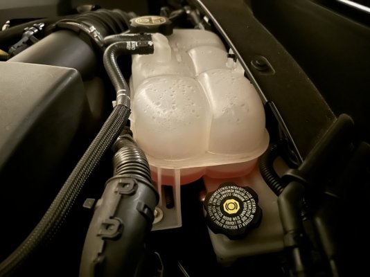

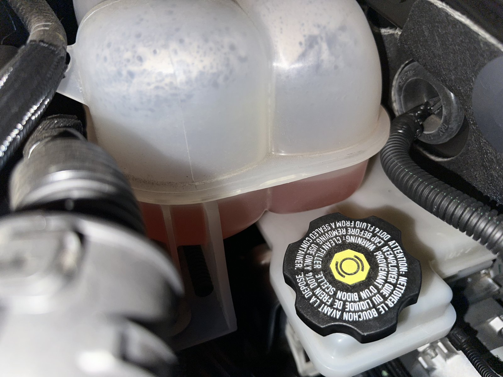

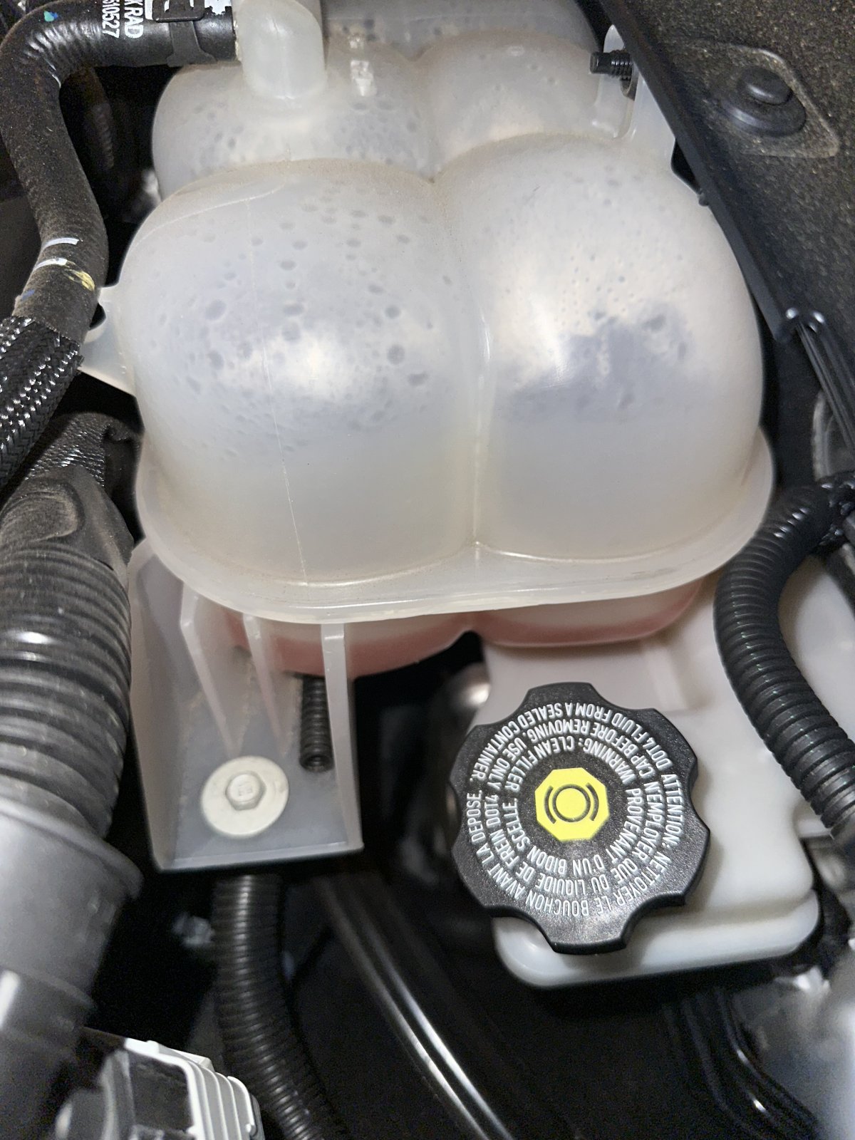

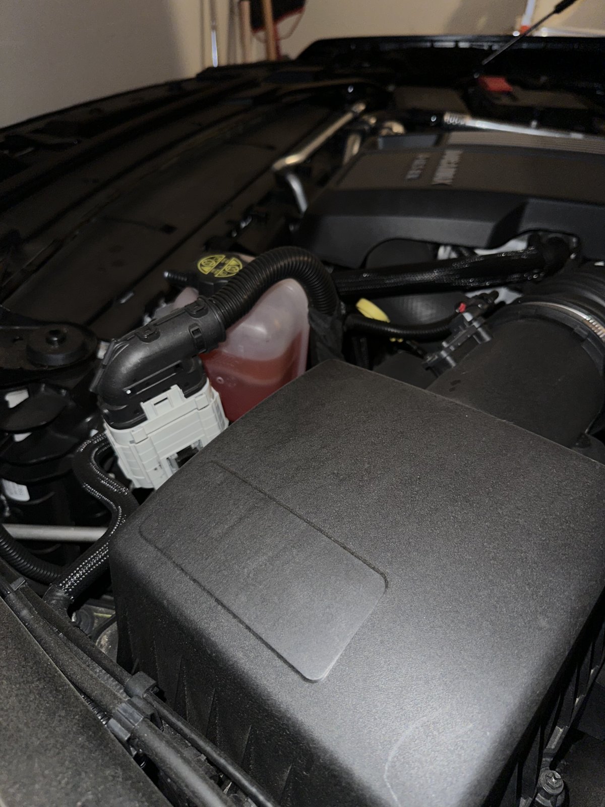

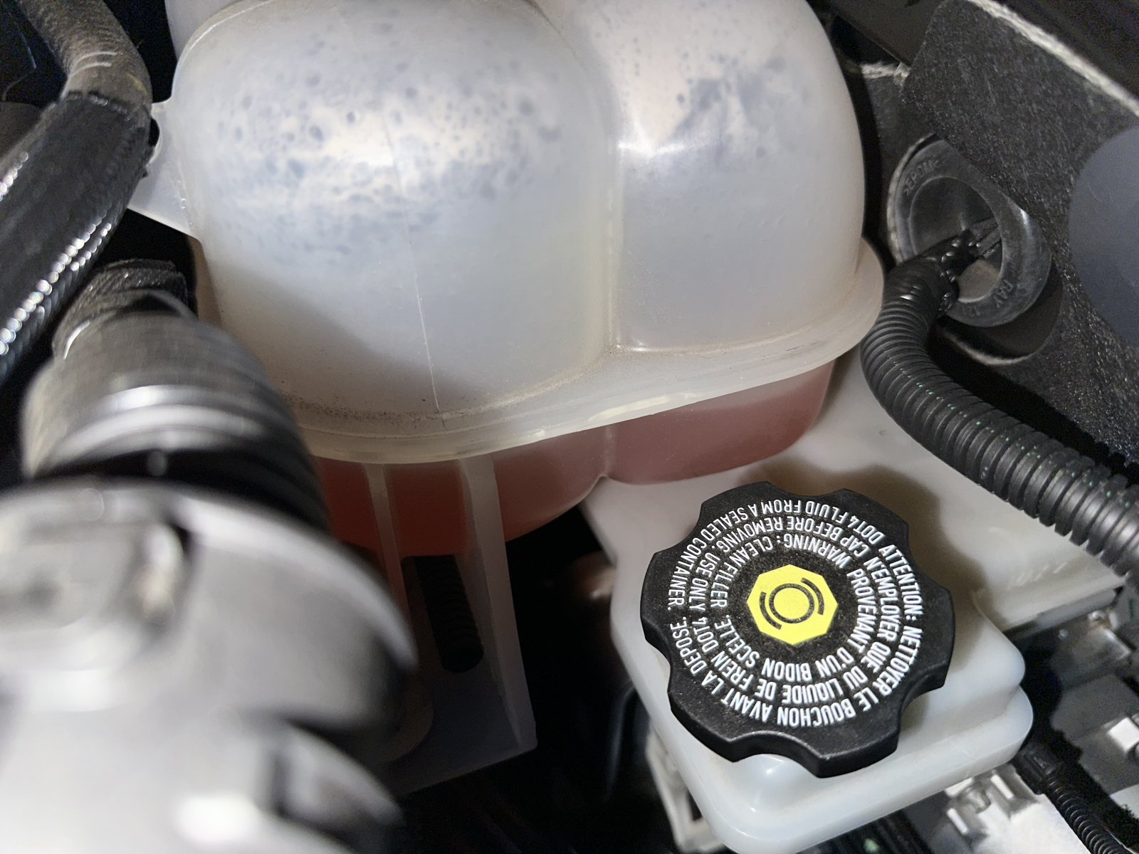

Hi there ! I’ve had my 22 Yukon xl denali duramax for about 7 months and love it !
I opened the engine bay today to look around and noticed that the coolant level looked a little low in the engine coolant surge tank (about an inch below the big halfway seam) . The attached pictures were taken about 4 hours after the engine was shut off .

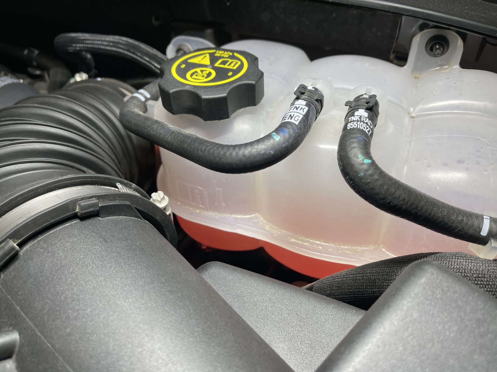

The charge air coolant surge tank seemed to be pretty full .
Apologies as I don’t have much experience with this , does the coolant level in the first tank seem low to any of you guys given the fact that the engine has been shut off for a few hours ?
Thanks !

Looks just like mine. I notice the full line under the hoses is at the seam, but can't tell if that's for cold or hot. I guess labelling it with a C or an H would have made it too easy for us.

great info ! Given the fact that I checked the coolant level this morning and it was at the same level as in the pic before I started the car (I would assume cold ) , do you think that the fluid is at an acceptable level (below the halfway point seam)?
Super Moderator
8,302
15,790
Elev 5,280
I think that level would be okay, but I'd top it off and keep an eye on it. Sometimes it takes a bit to purge any air in the system.

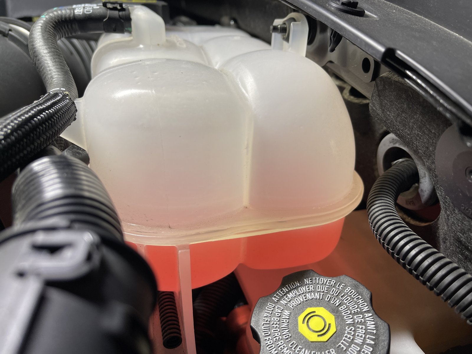

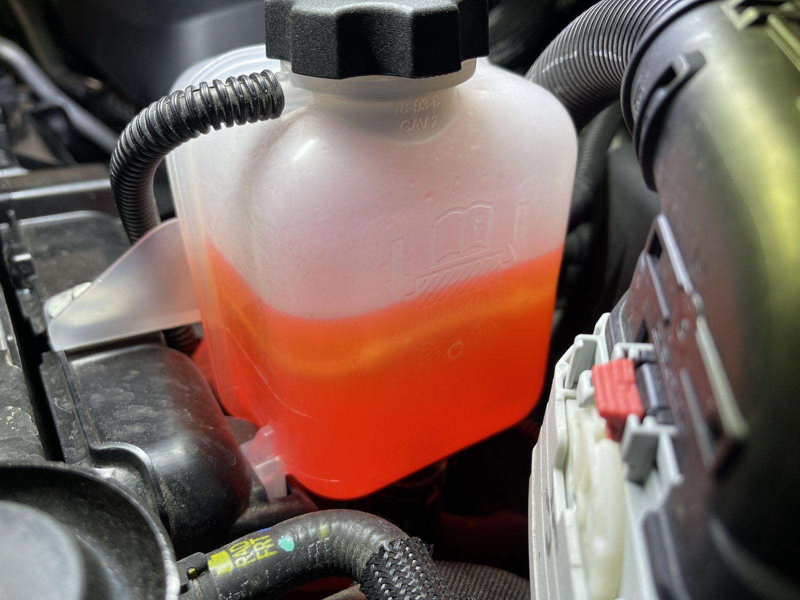

Here’s mine. 3.8K miles total. Looks like your engine surge tank is a tad low. Level when cold should be right at the seam of the top and bottom pieces that make the surge tank
Thanks for the pics and this super helpful ! Your charge air tank seems a little less full than mine . I don’t know much about these systems , but do the two tanks transfer coolant between them , thus the fluctuation in levels ?
I just got back home a few minutes ago and noticed that the coolant in the engine coolant tank had risen a little bit (perhaps half an inch ) , but still a half inch short of the seam .

Completely independent systems.
Your surge tank is a bit higher because you checked it shortly after you got home. Best to check it the next day.
