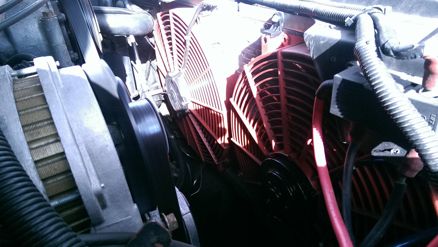

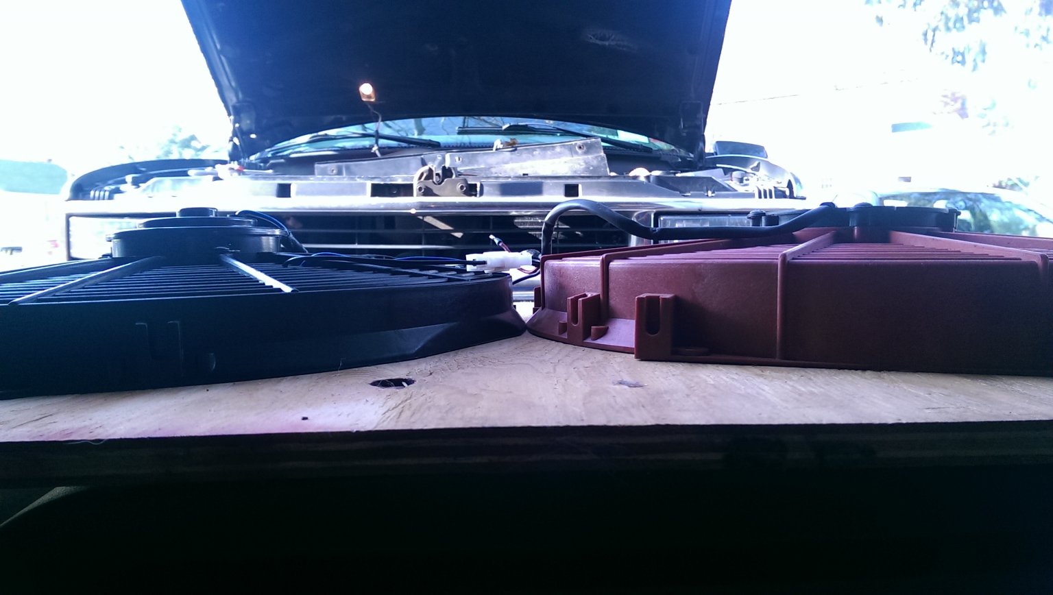

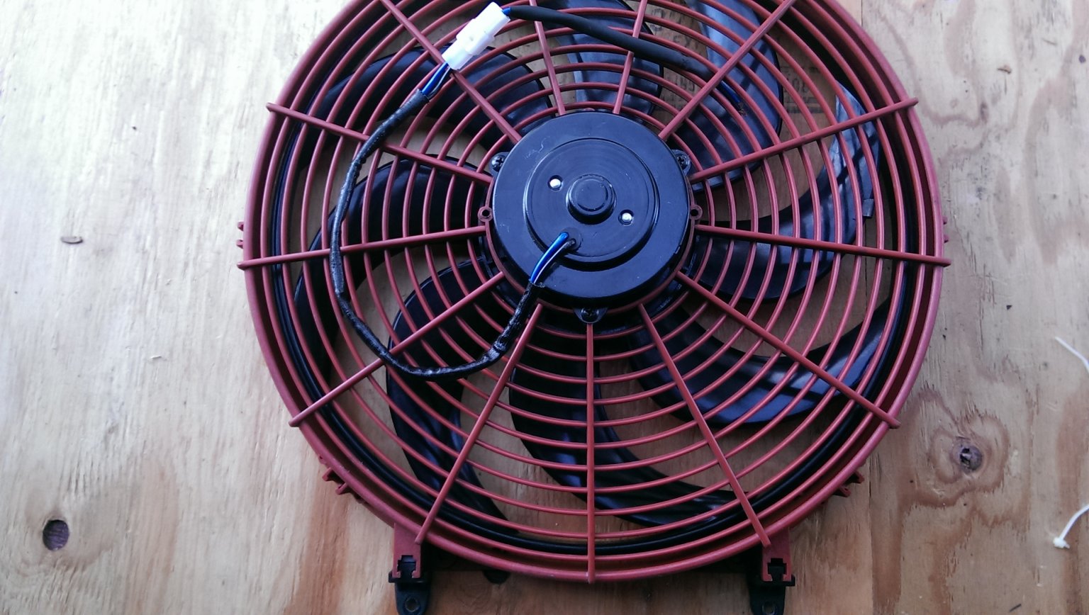

The fan is nicely made and the motor does seem heavy duty. It comes with a connector on the wiring which is a nice thing to have. Blade pitch is about the same as well as the noise they generate. Below are some pics of them. The one thing that the ff dynamics fan had was a deeper fan housing and the mounts were located at the top of the housing which was how I mounted them to my radiator. Since this was how I had it set up already, I swapped the new fan parts into the dynamics housing. You'll see what I mean from the pics. BTW I moved the temp sensor to the bottom of the radiator by the outlet hose. The reasoning for that is because this is the temp of the cooled water after it has flowed through the radiator. No reason to have the fans come on if the radiator is doing its job.

The new fan is just as powerful if not, a bit more than the FF Dynamics. I'll post any defects that may arise, but for $52, i'm a happy camper!
