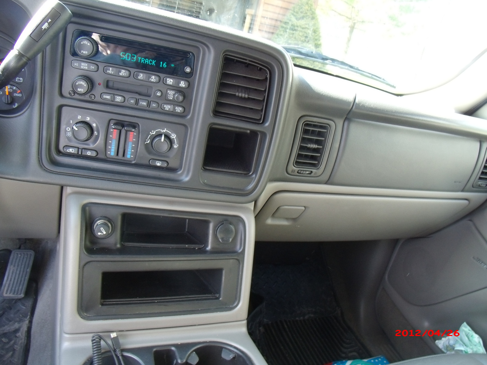

Are you sure it has rear defrost? Does it have the grid on the rear windows?

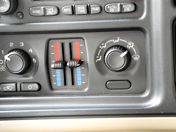

If your interior looks like this, it is below the defrost/panel/floorboard control:

Thanks BirchyBoy ... yes, I have a defrost grid on the back window, HOWEVER, that button below the output control you've illustrated / mentioned is blank (no icon) in my vehicle and it doesn't actually depress or anything when you try to push it.

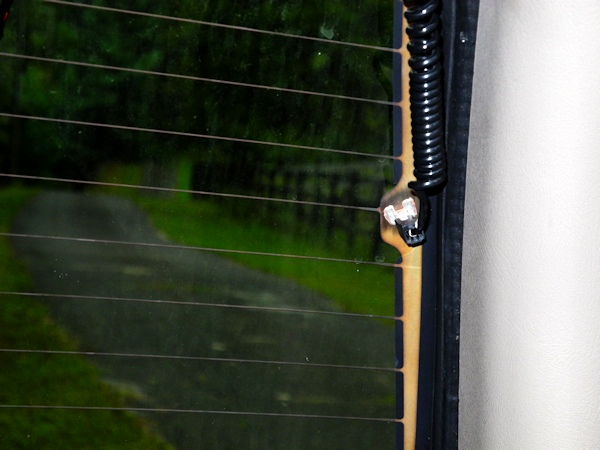

Hmmmm..... now I'm second guessing myself and will have to triple-check the back window for the defroster wiring / grid. I'm 99.9999% certain it's there. I'll reply back once I get home and can look. Love my Tahoe, but not the gas mileage for my daily work commute. :)

Its also possible that the previous owner replaced the AC panel with one from a truck with no defroster.

Yep - back window has the defroster, and Nope - no active button to turn it on. :shrug: So at one point something was swapped out it looks like. Bummer! Stinks not having a rear window defroster that works.

Yeah my guess is someone replaced the AC control panel with a pickup version. You could always buy one with the button on eBay. I'm sure the button is soldered into the panel. Much easier to just swap the whole panel.
