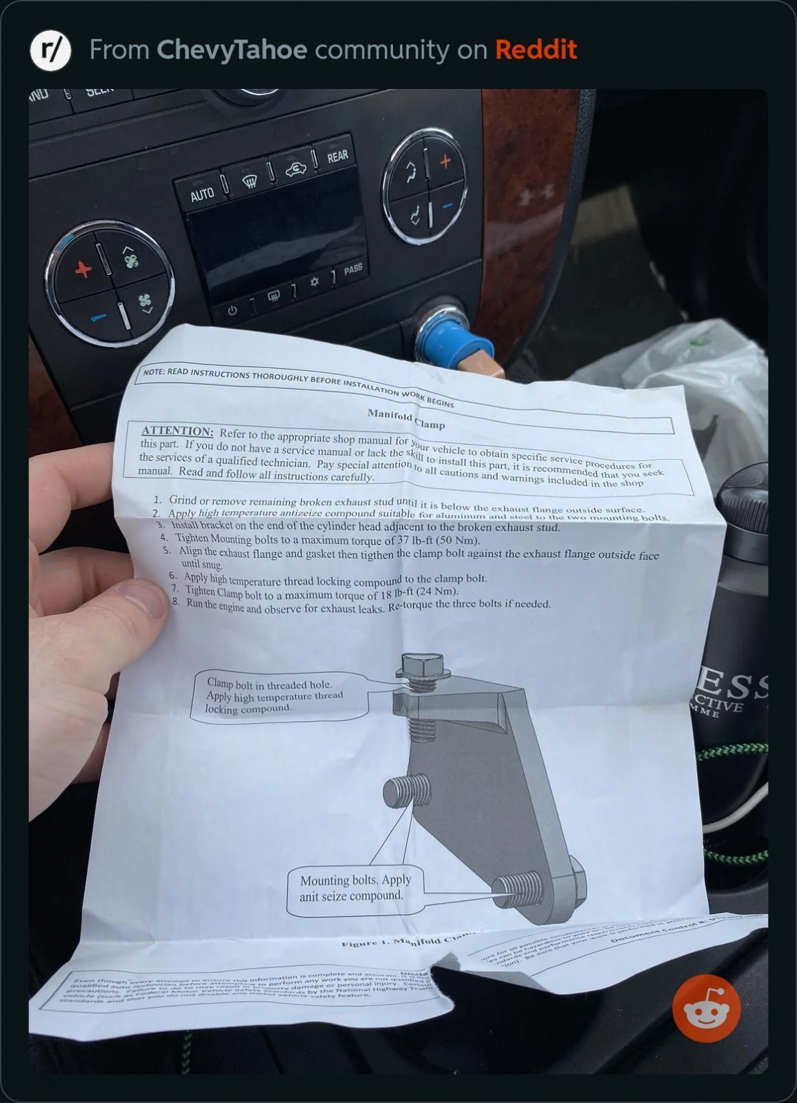

Easiest way to install manifold clamps? Dorman Manifold clamps

LOL, I bought one too and looked at it and thought the same thing. Still havent installed. I do need to do it though. Not sure how much to fix it correctly but can't be cheap.

When I did mine, it was in my friend's shop and up on a lift but he still had it easier than me installing them. Smaller hands and younger. Plus, we had the manifolds off for motor mounts.

Yeah I was gonna say try from underneath or pull the inner fender and try from the side?

I did the drivers side rear.. the holes where a bit off on one of mine, took a bit to figure out why I couldn't get the 2nd bolt to start.
once I figured that out, opened the hole up wasn't bad. a flex head ratchet wrench was handy to tighten it down. I do also have a top side creeper at work. so that probably made it easier for me too.

So the OEM manifold bolt stud must be removed or ground down below the exhaust header flange? That means I can’t install the clamp with intact bolt studs. I was wondering if anyone uses a similar clamp to supplement the existing intact bolt studs.
Rather than that, why don’t we proactively remove and replace the bolt studs one at a time? Would that require a full manifold removal and new gasket? Or can it be done in place?
