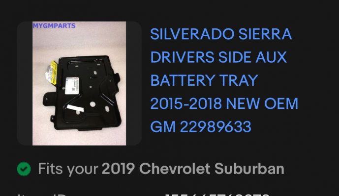

thanks for the wrieup. I have a 2018 tahoe and i am planning on doing a dual battery setup also. This helped me map out the layout, but I think im making my own since I plan on running 1/0 cable to both with a bigger alt upgrade. I think I will just run parallel with a relay for an isolater when needed. I am also trying to figure out how to get a H7 into the driver side tray so I have matching batteries. anyone able to pull that off yet?
I am planning on starting a project for my 2017 Tahoe. Which tray did you use, most of the trays I have seen do not list 2017 as compatible.
And truth be told you could modify the incomplete tray that is already in there. It is just missing a little piece of metal that traps the bottom of the battery on one side and the welded nut on the other side that the hold down screw and rubber block attaches to.
