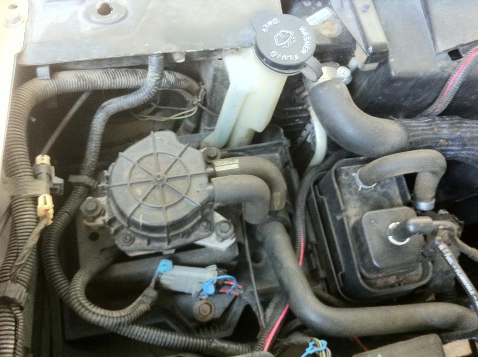

Prior to my acquiring my 99 Tahoe, i had two 97's. Both of the 97's came with the second battery tray installed and ready to accept the second battery. My 99 however has the air injection pump sitting in the second battery tray. Is there any way to relocate the air injection pump? I'm trying to remember if my 97's had an air injection pump and if so where it was mounted. Maybe i could possibly change to the earlier pump?
The attached picture shows the Pump and the Tray which even has the factory battery hold down and bolt in place.

Air pump was intoduced in 1999 since there was no diesel in that year that needed the extra battery the storage box was deleted and a pump added in its place.

Well, Ive been looking at it and I'm thinking that i need to move it then. Looks like it probably wouldn't be too hard. The other thing i was wondering is if i could remove it completely, plug the manifold holes and have Black Bear tune it out of the computer. Would a CA smog machine pick it up? I highly doubt that the old guy that smogs my truck would even remember it upon visual inspection.......

It would be discovered visually big time. It would be called out to if it applies or not and the techie would have to mark it as n/a so yes they will look for it.

That looks like where my (only) battery is, and the 2nd battery tray (storage box) is on the other side of the engine bay.
