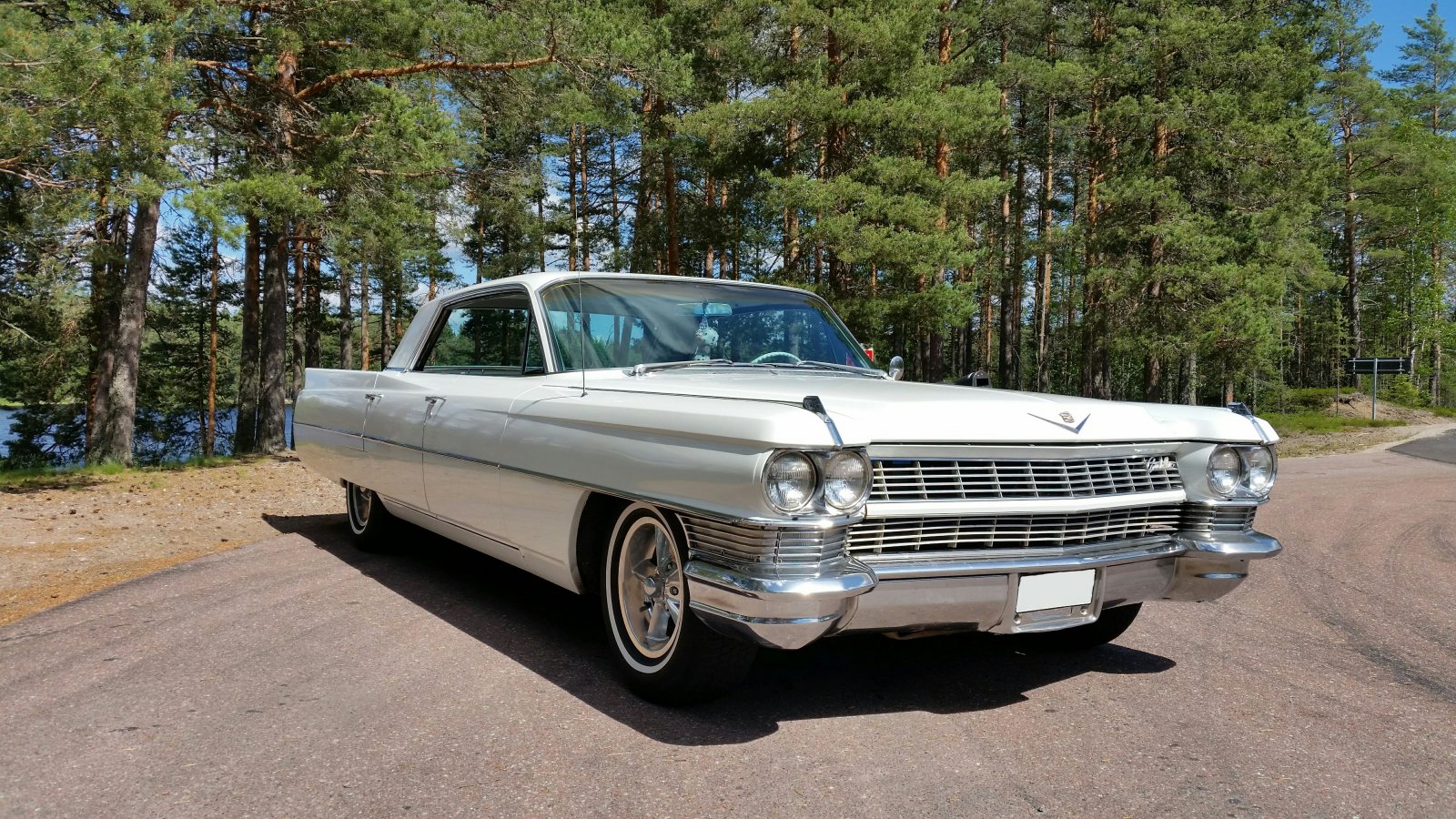

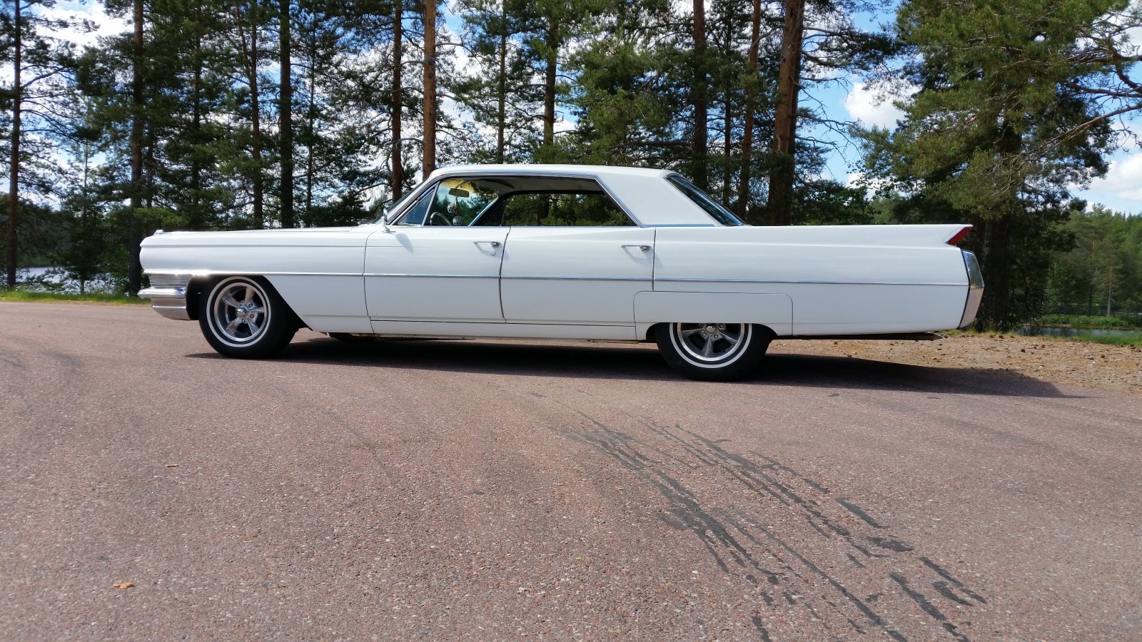

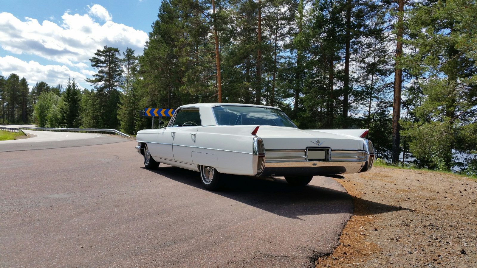

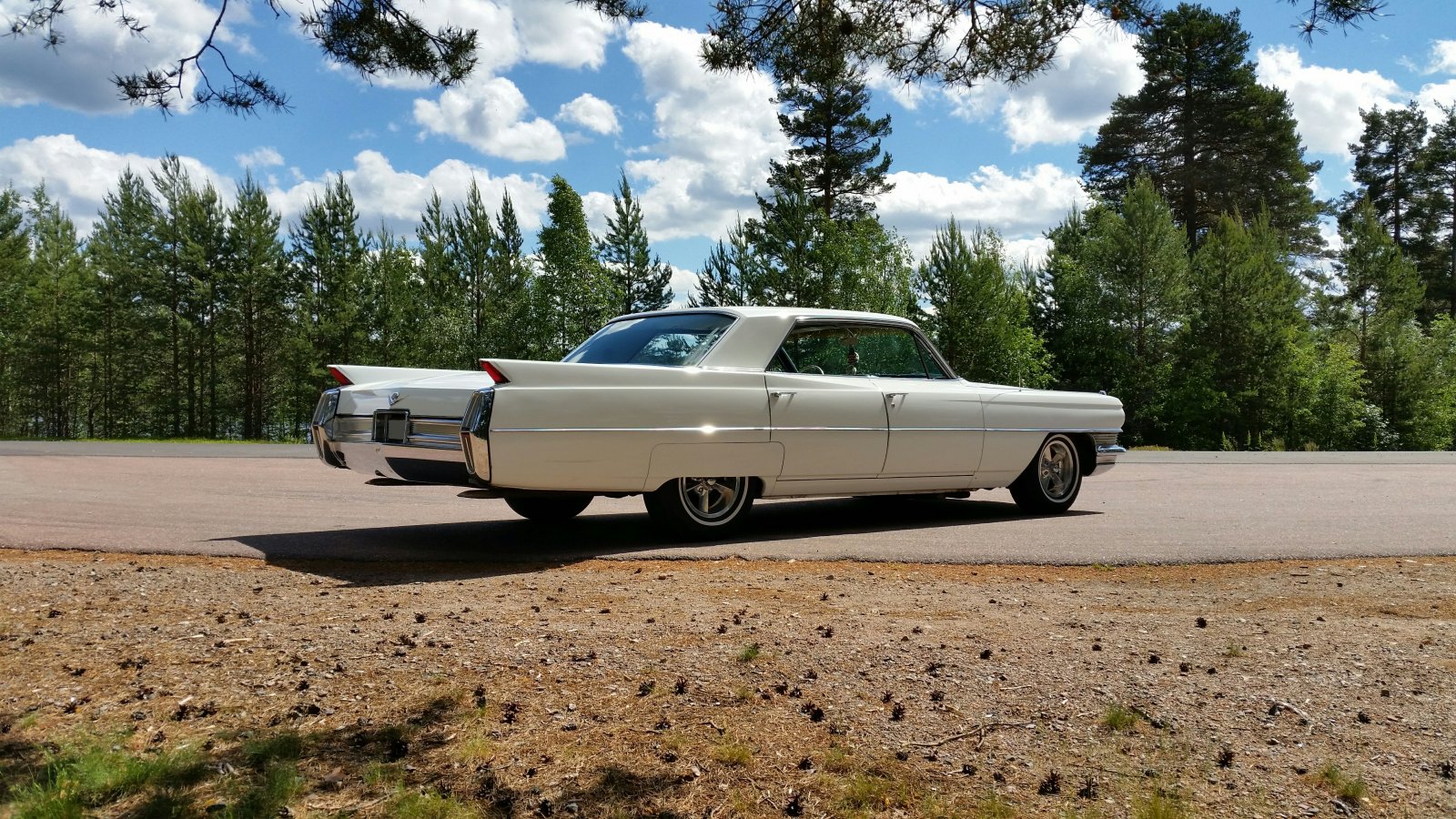

Have a 64 Series 62 4 dr/4 window and want to drop it in the front but I am not sure how low I should go? The car are stock otherwise but I think it's look to much grandma and grandpas go to town car.
I was looking around 2" to 3" lower springs but what do you guys say? Bags are out of the question, I am not in to it at all. As more analog we can go as better.

Looks great, I would go zero inches of the drop in the front and rear! Gramps! ;)

I agree with @swathdiver. I think it looks great the way it is.

That is a beautiful car as it stands now. If I had that car, I'd be out cruising every time that the weather allowed.
Why mess it up by trying to turn it into an urban crawler.

Thanks guys for the input. ☺ I will not cut the original springs, I will buy new ones if I would do anything, wouldn't ruin something on it.
I don't remember exactly but the Series 62 was around 13500 cars 64 and my have production number 842 so I will never go crazy with it, I guess that aren't many Series 62 left with lower number then mine.
And yes the car are used, I do have it as daily driver in the summer. ☺ I drive it to work and use it as it was maid for in the first place. Have cars standing just for showing off and see them as a jewelry are just silliness. I drive and smile with my cars. ☺
Lets hope for more inputs! ☺☺☺

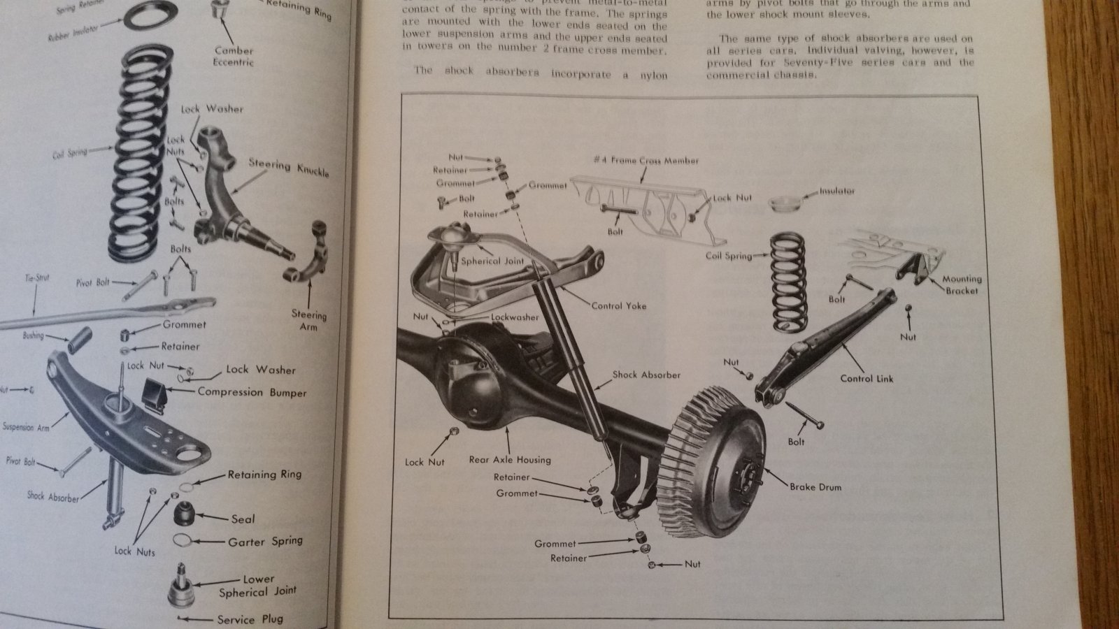

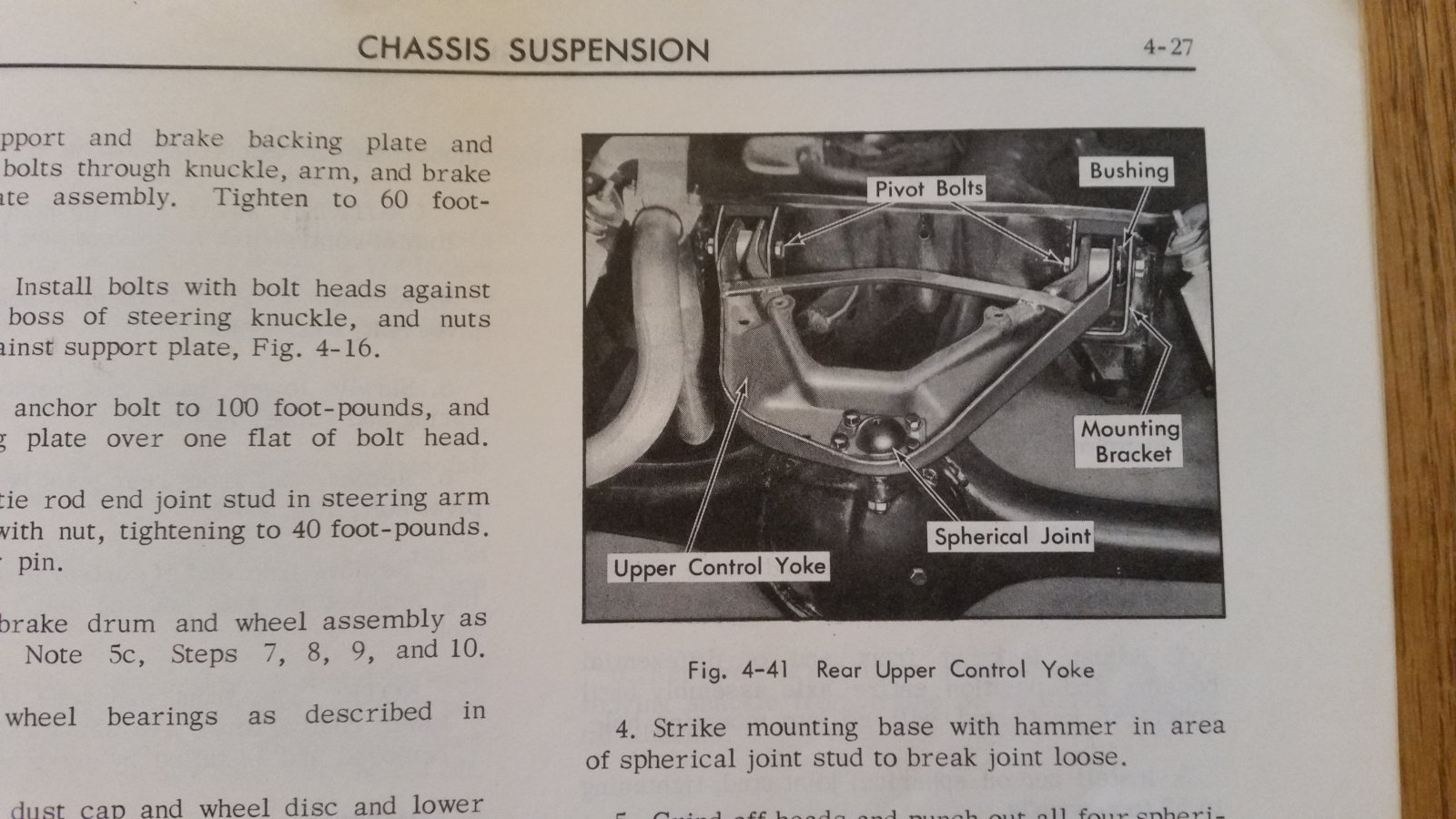

Take a pic of your rear suspension if you can. I assumed it was a simple 4-link design like my 67 but looks like it maybe a 2-link with a wish bone(ish) design. Still doable for any heights but may take more than just springs.
It's a regular suspension with lower control arms and a big ball joint in the upper differential housing. This models are notorious for vibration so I don't want to mess with the rear. It wasn't many degrees before you need shim the transmission on this. I can later take a picture from the original Shop manual so can you see the construction. ☺

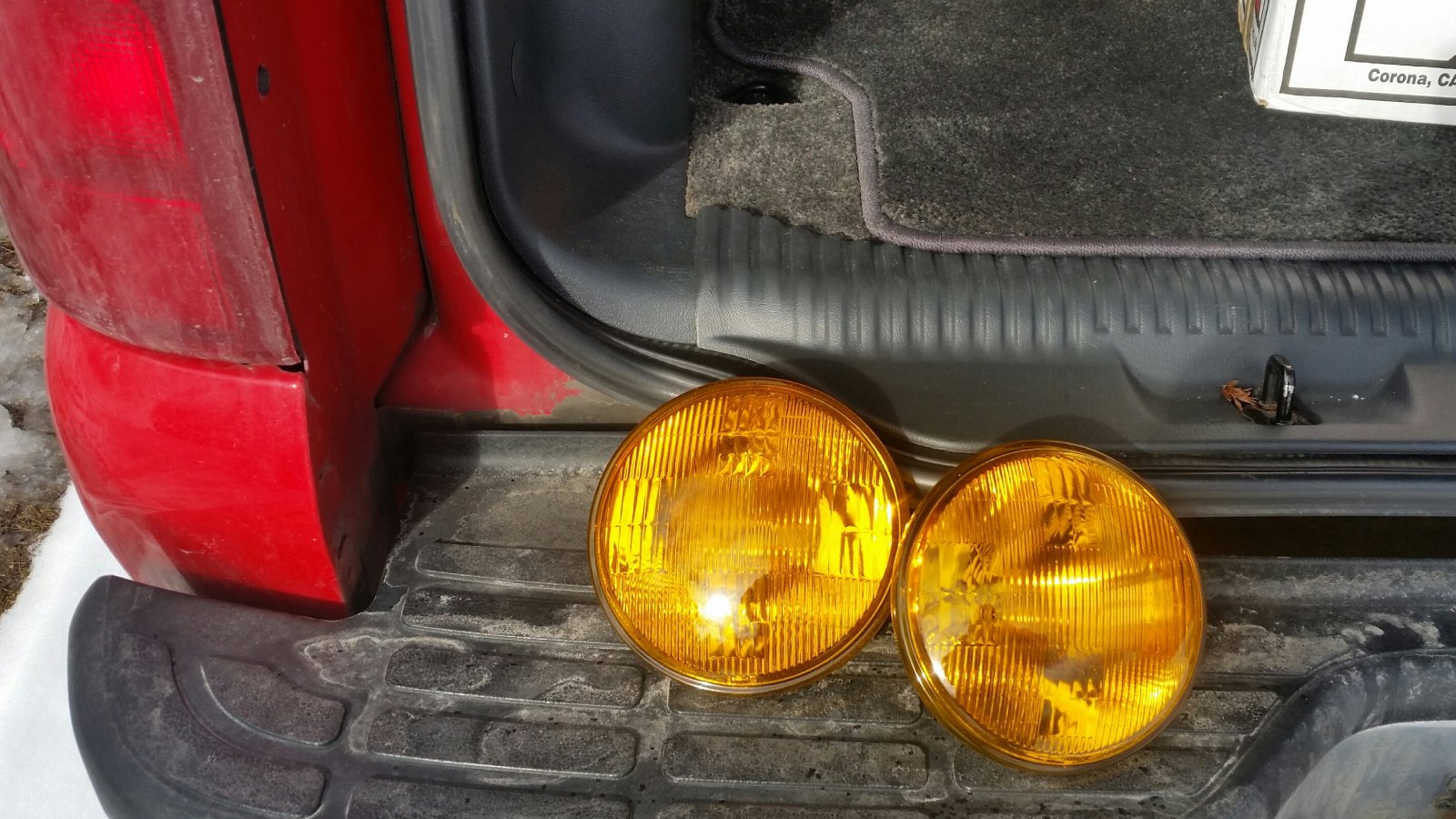

Did a mistake and did order 4 amber sealed beams (5-3/4", did see in my head some beautiful retro touch but think those will look like 4 gigantic turn signals.

Headlights are supposed to be white. I remember using those bulbs for fog lamps. Why not put the half moon glare shields on your headlights. They give a sleepy cool look and actually improve visibility in rain and fog. When I drove a truck, I used to make "poor man" fog lamps with duct tape.Several layers over the top third to flatten the beam and reduce glare.
