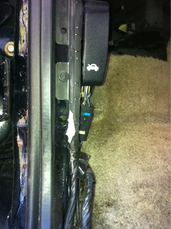

My driver front floor is really wet. Closer to the seat than the pedals. I pulled the carpet back to let it dry and could not find a source. Any ideas? I'm new with these SUVs. If it were If it were heater core it would be on the passenger side right???
Thanks in advance for any help
Hey man, I’m currently experiencing the same issue and I found out the culprit. It was a seemed joint that has cracked over time. I’m going to use etc to help it.

I had wet carpet on driver's side in the 05 Tahoe and it was from where the body panels are joined, right below the windshield and where wiper trim and hood hinge are located. If you look there you will find the seam. There is one on each side. I found the best sealant I could get at the time and multi layered over this seam on each side. This solved my issue. For good measure I ran over to the 2004 Yuon and found the same seams, with the same cracks and filled them as well. No issues so far!
