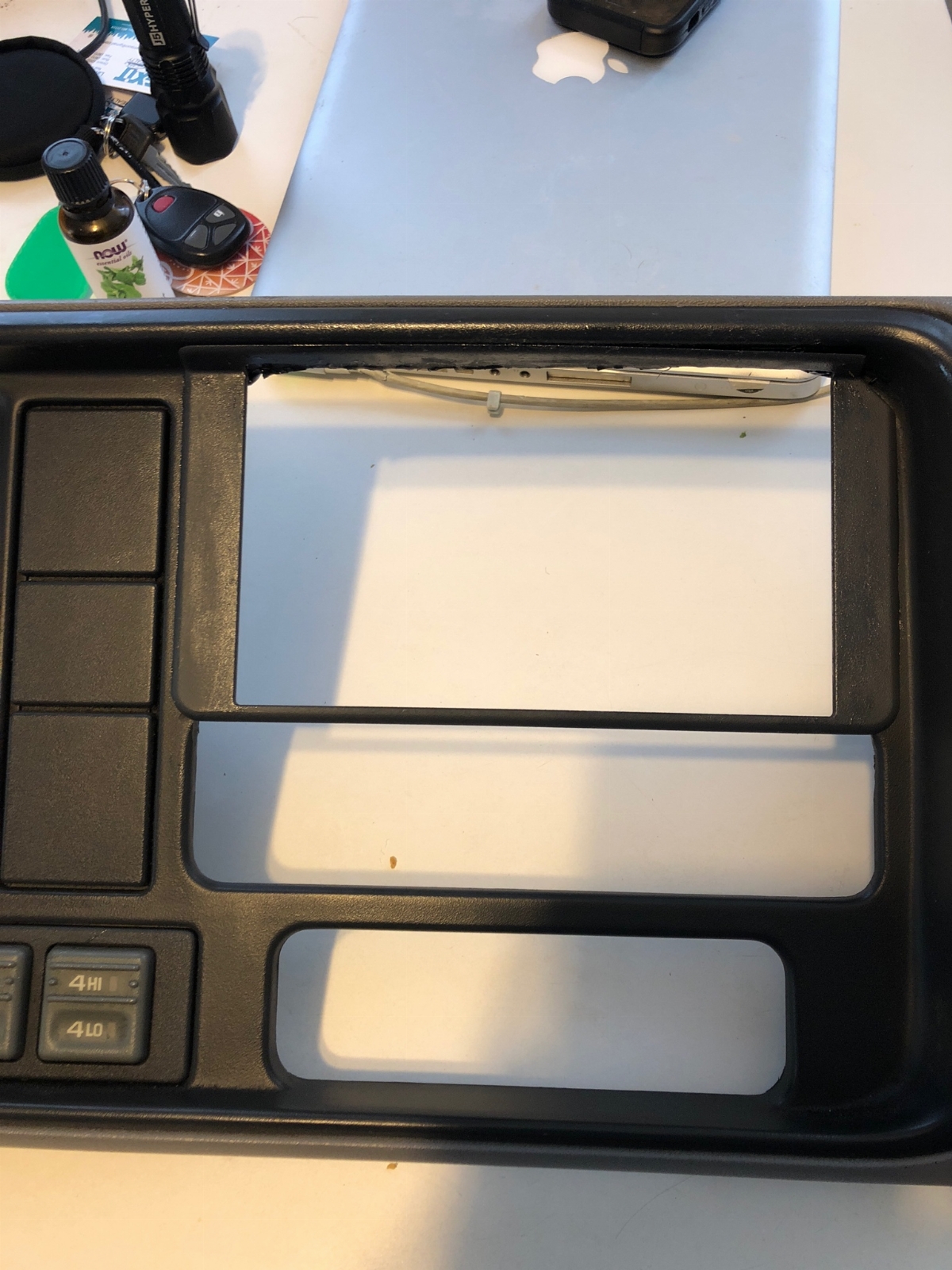

    Finish trimming plastic behind radio not cutting bezel for my pioneer 4201 NEX

    Metra makes a nice ddin conversion kit gives you a template for the trimming part# is 95-3003G

    thanks worked like a charm

    Used dremel to sand down used metro dp 3003g used some jb weld to seal the deal

    Looks good.
