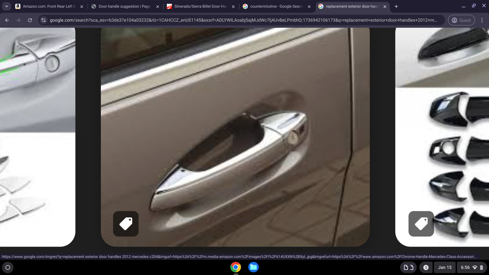

My wife's Merc coupe has handles that utilize the same style lateral pivoting lever. But the hand placement openings are not so centrally located across the handle. They're in a better position of leverage, offset towards the rear of the car, further away from the the much more robustly made fulcrum arm. You can rip away at them all day and they pivot every single time.
The GM design has far too weak of an attachment arm for the hand placement section to be that close to the pivot point. Rolling your wrist laterally, even slightly, to get a car door open is counterintuitive. It's the opposite of how you would think things should be designined
I hate to be so critical of one part on an awesome vehicle, but any kid who's been to a playground a couple of times can tell you what's wrong with GM's design on these handles....
It's time consuming to replace these door handles and seal the door cavities up correctly....and I'm too OCD to have 3 UV faded handles and 1 new one lol Screenshot 2025-01-15 6.56.16 AM.pngScreenshot 2025-01-15 7.08.08 AM.png
