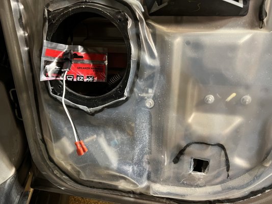

What’s involved in removing the door panels to replace the speakers? Any special tools needed?
It’s really easy. Front and rear are both held in place by 2X 7mm hex screws, and some clips. I find it easier to remove the door panel courtesy lights before starting. While they are out replace them with Amazon LEDs. Best to watch the YouTube videos but pics below give a good overview. Rear door is a little easier for first attempt because it’s a coaxial speaker not a component (woofer and tweeter) speaker. I used Polk Audio 6.5” (approx $100 / pair) in the rear and didn’t even need to drill new holes. I used Genuine GM OEM replacements (approx $200 /pair) in the front in order to utilize the “clip-in” front speaker design but if doing again I’d use Polk Audio in front also, with Metra 82-3002 5.25” /6.5” speaker adapter. If you use aftermarket speakers absolutely be sure to use the Metra or Red Wolf wire harnesses for GM vehicles so you don’t need to cut or splice the OEM wires.
It’s really easy. Front and rear are both held in place by 2X 7mm hex screws, and some clips. I find it easier to remove the door panel courtesy lights before starting. While they are out replace them with Amazon LEDs. Best to watch the YouTube videos but pics below give a good overview. Even better to buy your gear from Crutchfield and get their step by step instructions and super-helpful tech support.
