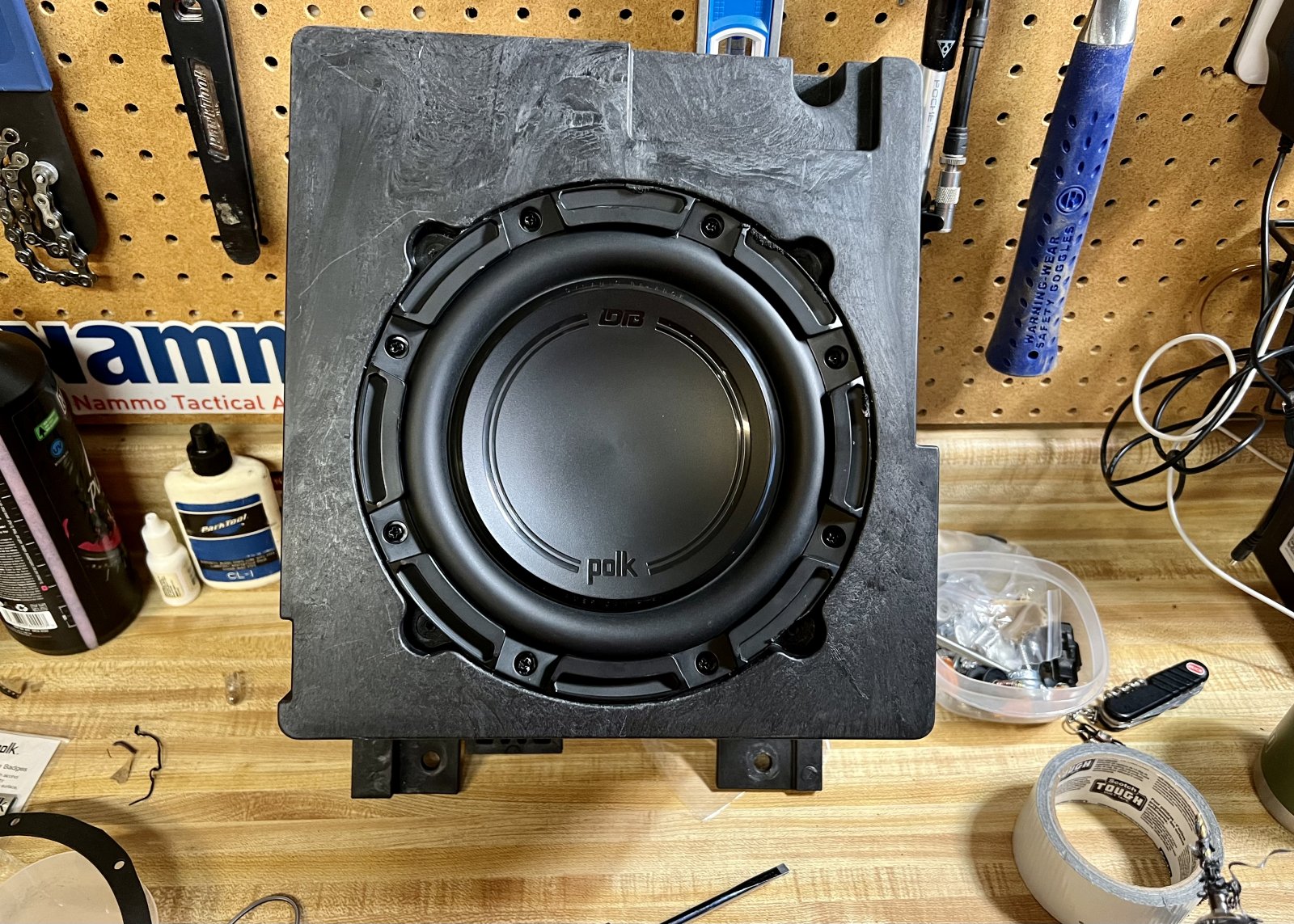

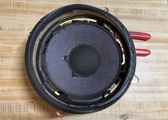

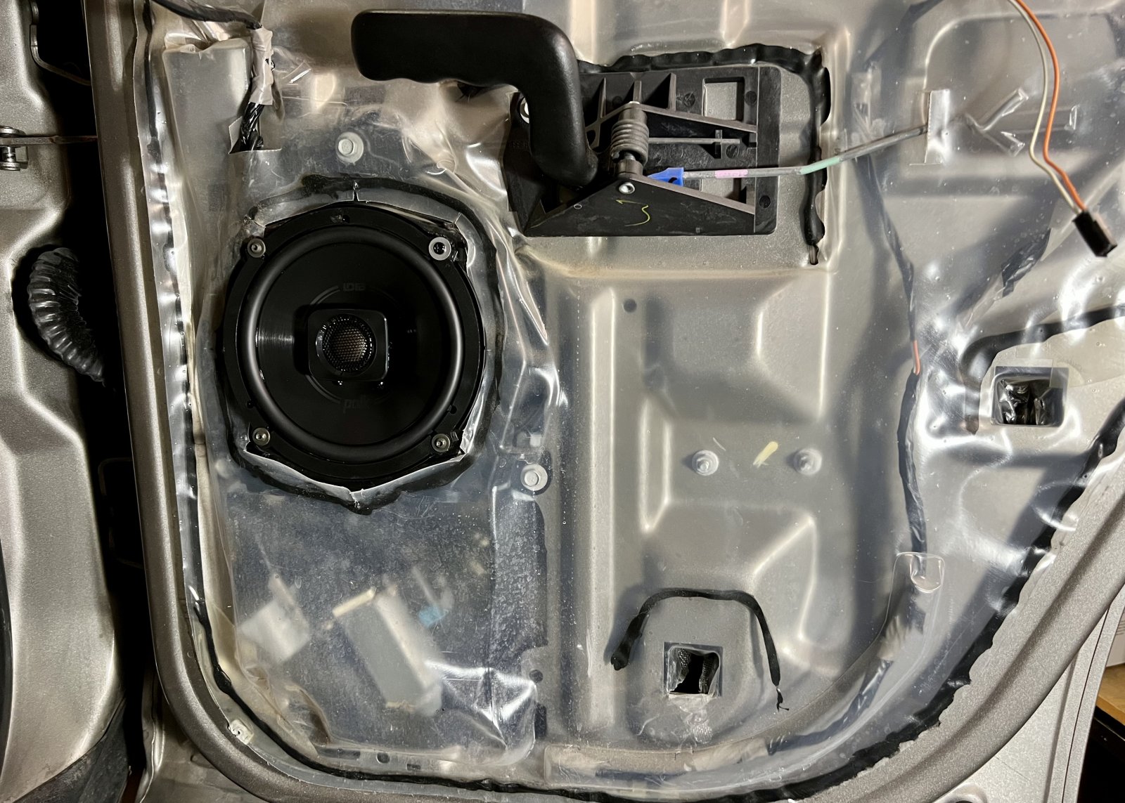

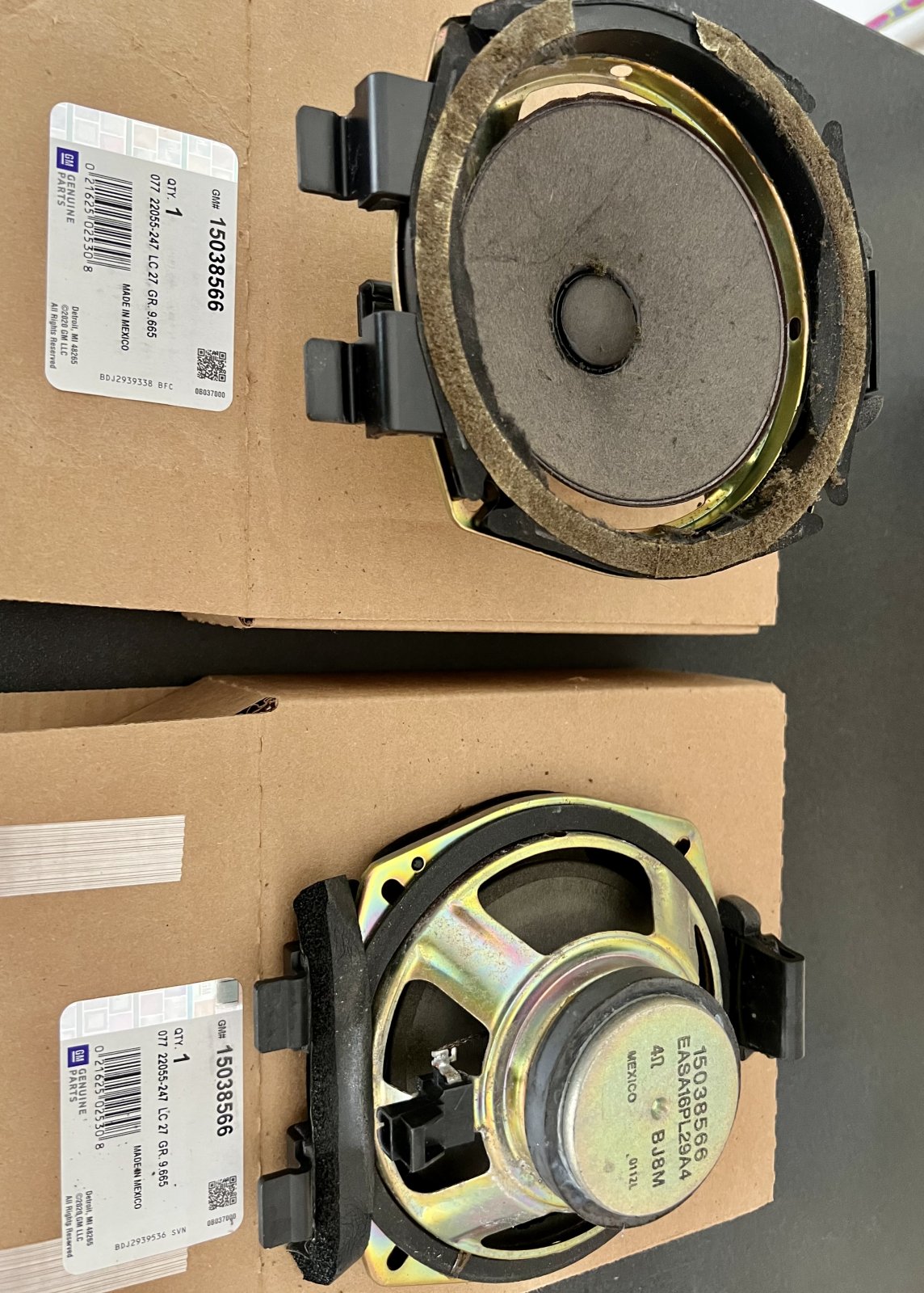

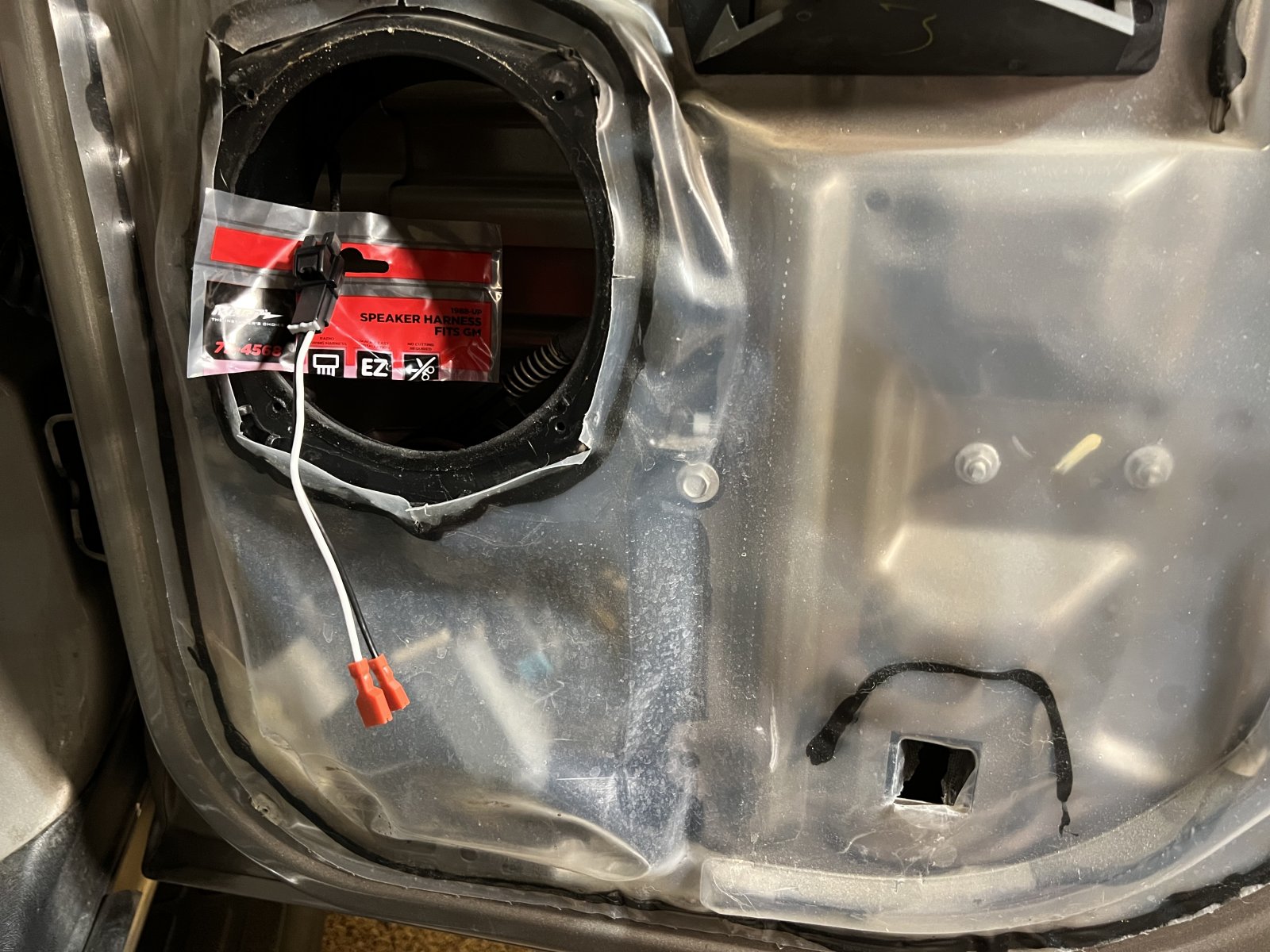

My experience with my 2001 is that the speakers are the weak link, and sonically testing your amp with your ears on ten-year old speakers is hard to do.
I just finished replacing all the speakers. They were all severely degraded. The subwoofer sounded so bad I THOUGHT the amp was blown but after replacing with an 8” Polk, the OEM amp is carrying the low freq’s much better. The original door speakers were not much better. I really like the Memphis Audio mids I out in the rear pillars too. Pics below.
I’m pretty impressed with the OEM amp. It’s not loud, but it’s loud enough, and clear, especially with digital music (file or CD) rather than FM Radio Signal.
The non-Bose OEM amp runs pretty cool, and is installed in a great location, gets HVAC flow.

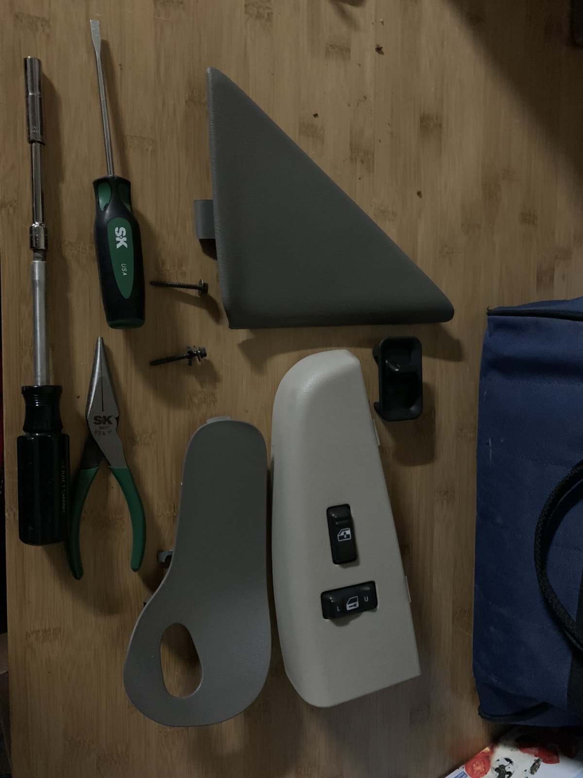

What’s involved in removing the door panels to replace the speakers? Any special tools needed?
