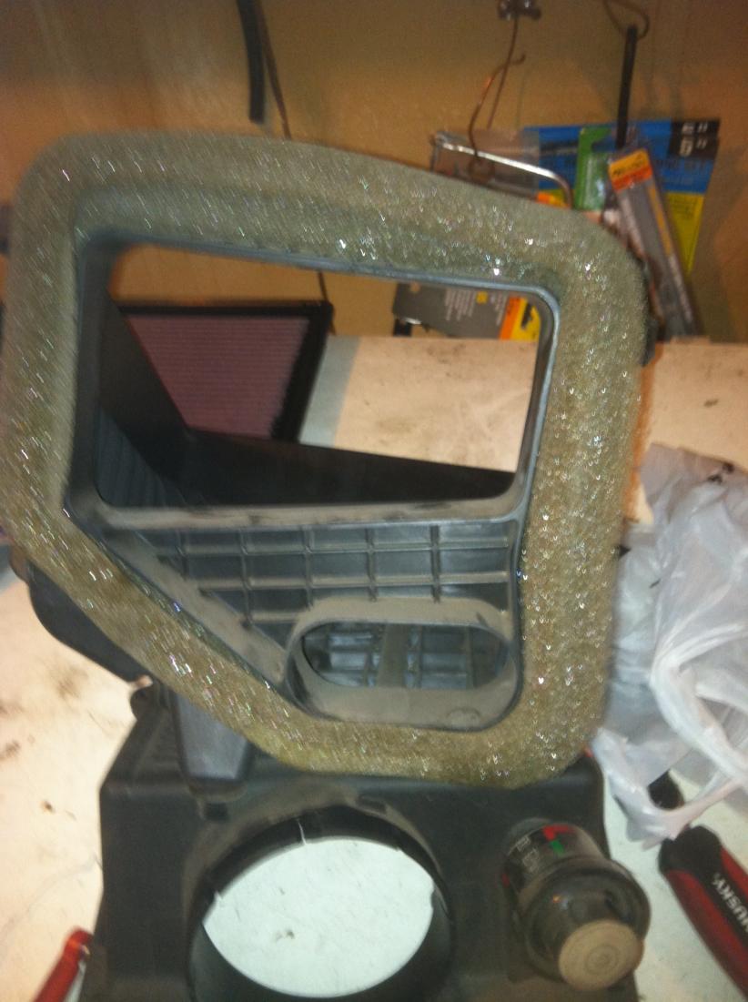

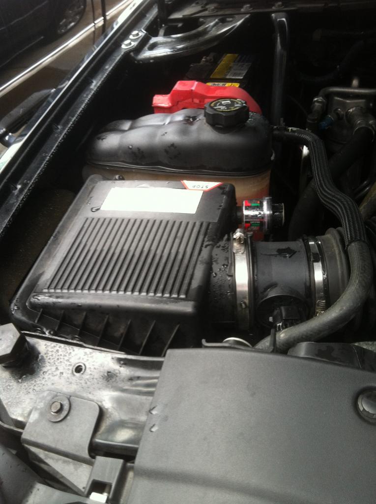

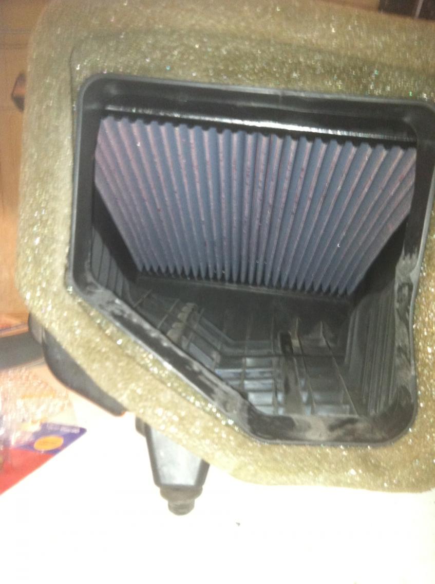

    I looked for any DIY threads similar to what I did and could not find any.
    Since I decided to tune my Denali going with EFI from MJ Engineering which I ordered yesterday.
    I did my DIY intake mod which really woke up my engine. :happy3:
    Using K&N drop-in airfilter which I have had in since 2008.
    I can only imagine how well it will run once I get the EFI AutoCal tuning.
    I did this mod to my Dmax in 2008, it worked very good and the gains was similar to others that had Banks RamAir and S&B CAI intakes.
    The Intake Ambient Temps dropped 20-25 degrees and the MAF g/s @ idle went from 26-28 to 40-42, using aFe ProGuard 7 drop-in airfilter.
    Monitoring PID's using the Edge Insight on my Dmax.
    The nice thing about doing this compared to buying a CAI you don't have to worry about MAF location issues.
    Cost about $45-$50 for the K&N and about 2 hours labor. ;)

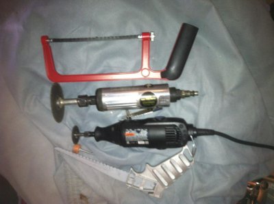

    As far as seat of the pants testing this was more noticeable on my Yukon Denali than it was on my Dmax.
    I used a combination of these tools depending on what was the easiest to use.
    Remove the filter from the box when cutting and be careful when cutting around the foam seal.

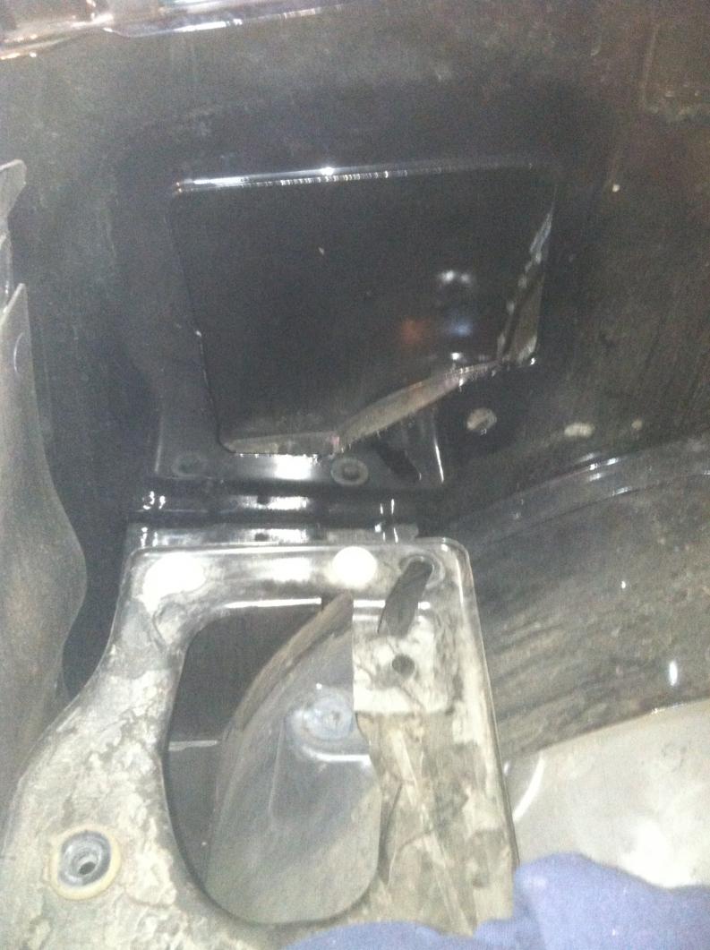

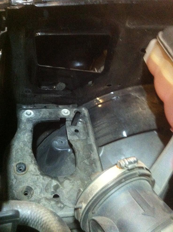

    Aaron
    I was looking at my dmax and its open like that but on our denali its got a different edge that runs on fender with two opens that line up with two slots on the fender. Is the 03 denali a different box. Or did you just cut yours before pic and cut fender as well not scared to do either just wondering if mines different for any specific reason
    Sent from my iPhone using Tapatalk. Excuse my grammar the iPhone makes me iStupid!
  6. D_R_C
    D_R_C Full Access Member
    Posts:
    97
    Likes Received:
    Joined:
    Mar 4, 2013
    Name:
    Dan
    These are before and after on my 07.5 Dmax I also cut out the intake to match, the same as I did on my Denali.
    As far as the 03 I don't know
