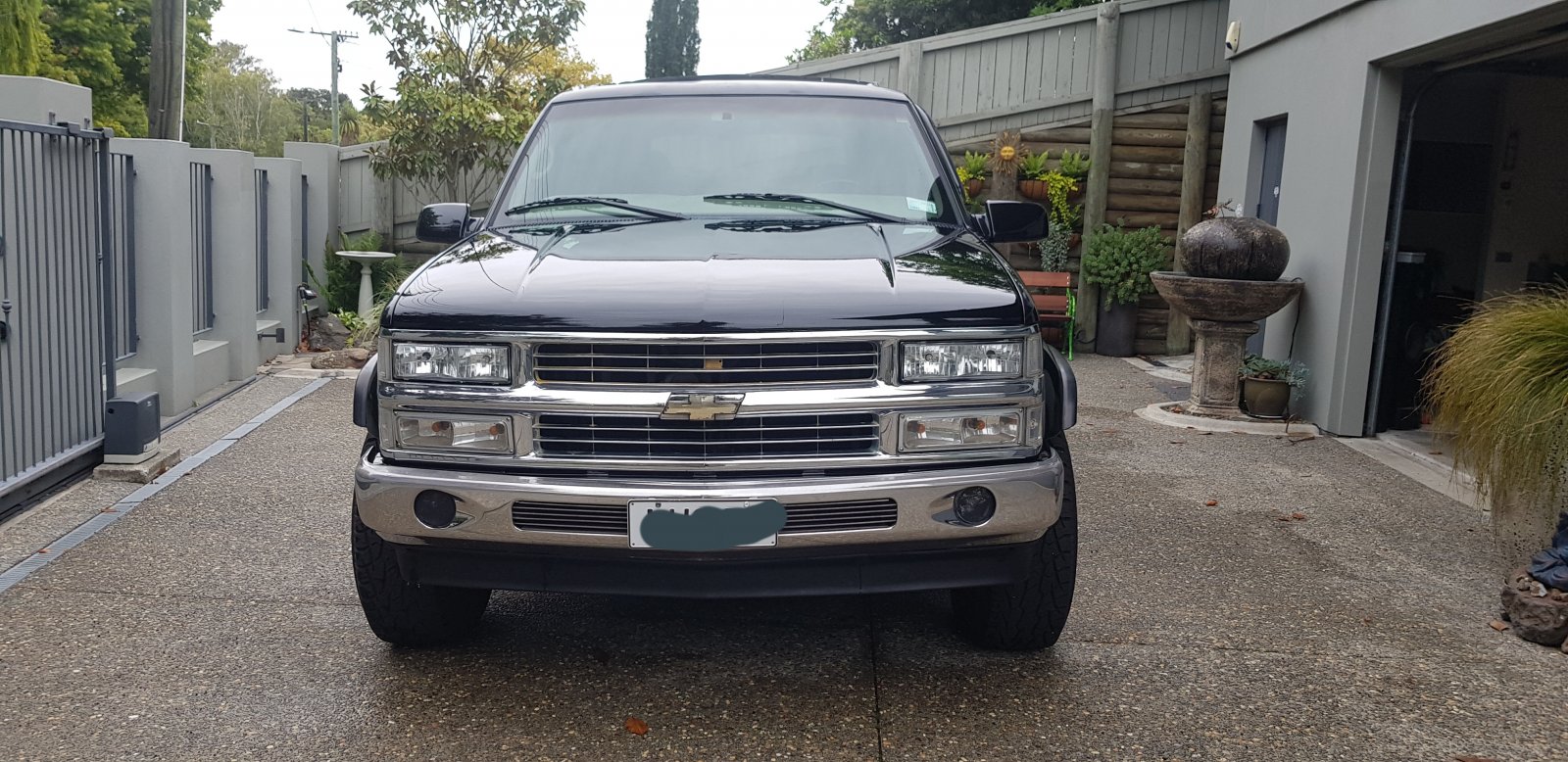

Hey Jeff
Dont know if my info will help but my 97 yukon doesn't have remote access. I have 2 keys only no fobs. Can central lock from both front doors and rear door.
Think an alarm install will give me remote access.
Cheers

Alarm system is the best solution , i had a Viper system installed on my 2000 and also on my 2013. Has remote start (up to 3/4 miles), lock, lift gate remote (not an issue for your ride I know, but a nice feature). You have a nice looking ride BTW.
