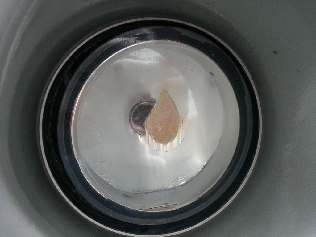

Hey guys, need some opinions here. I have had HIDs in my foglights for a bout 4 years and they have melted lens. It was a point where it didnt bother me muhch, but more recently it has become something that needs to be fixed. The passenger side has cracked and water is getting in. I need opinions on what to do. Here is what i have found:
What mine look like:
OEM: (which will eventually do the same thing and melt)

I guess my fourth otion is to get OEMs and put in LEDs but I really love the functionality of my 3k HIDs in bad weather and dont want to give that up. Suggestions welcomed. Thanks

Haha. Yeah, it seems like the way to go, but just exploring my options. I wish there was like a way to recess the bulb further back or get a different bulb that wouldn't melt the housings

I think I have decided to get oem housings and I heard completely forgot about 25watt ballasts. I think I buy those I won't had to worry about melting. Can someone direct as to where I can buy just the ballasts?

I had LED fog's in my 08 tahoe and it looked sick, but virtually had no light output. I now currently have HID's in my fog's in the Esky and one of them went out (i'm guessing a bad ballast)... Basically something will alwayssss go wrong regardless of the route you go. Personally, I'd go with OEM and try to get some 25W Ballasts instead to reduce the amount of heat. Then if you really want to get nuts, go to The Retrofit Source and buy some projectors and retrofit them into the OEM fogs :)
