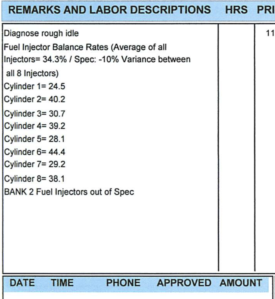

They are linked together. I took it to 3 dealers around Raleigh - Hendrick GMC, Thompson GMC and Sir Walter Chevy. Both Thompson and Hendrick shared with Caddy -same service. GM Customer Care told me that they trust their dealers and will not send GM representative because nothing is wrong with the truck, what RPM Motorsports diagnosed is not relevant to GM, this is what their Social Media team at GM told me. Feels like a dead end. GM has grown to be the monster that can do whatever they want, set whatever "specs" they want. Hendrick GMC refused to disclose any "specs" because they know that my bank #2 is out of spec by 30%, Service Manager at Hendrick GMC named Rick told me that I owe you no results, this is confidential info, everything I need to know is written into a work order - "No problem found".

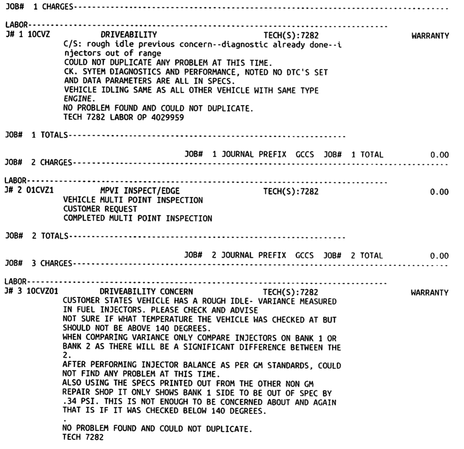

This is what Hendrick GMC "dealer" reported. Same truck, no idea of course how Hendrick tested... I am not proud of the GM and dealers in Raleigh area, none of them are interested to help customers, only there to help GM.
