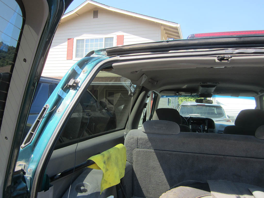

I added Sirius XM to the radio. The fun part was routing the antenna from the back of the vehicle. I came in through the vent and routed at the top of the glass line. I came down the a-pillar with the mic cable. While I was doing this, I removed the CD Player and installed a delete cubby.

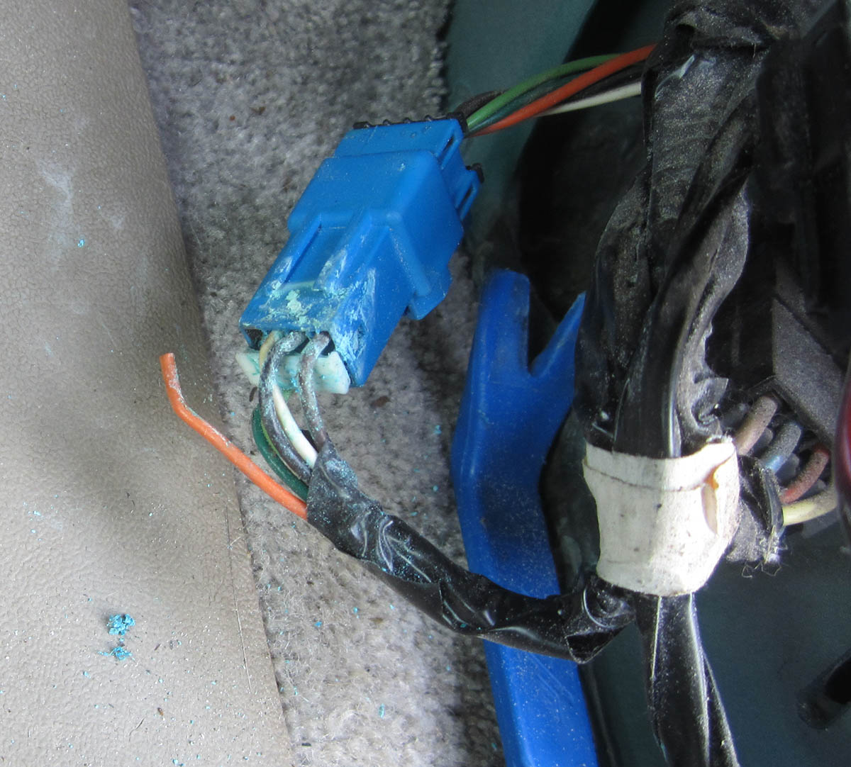

Thanks to a lot of help from East302, I was able to figure out why my passenger door courtesy lamp wasn't working. Pulling the kick panels is not particularly fun. Pulling the pin from the connector, cleaning it up, reshaping it and re-crimping it was easier than pulling that panel off.

Looks like some interesting coloured corrosion at that connector. I use an electrical contact spray that is awesome at work. It dissolves, cleans, inhibits corrosion, and makes great electrical contact. See link below.

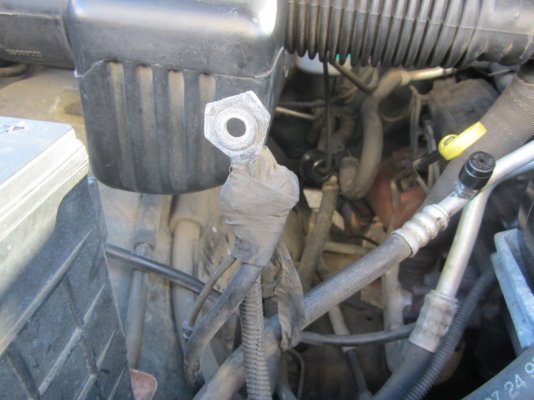

The battery cable was another fun one. I ended up with this terminal replacement part. I tried to find the whole harness, but just couldn't find it new. GM doesn't make it anymore. I wasn't happy with the previous owner's solution. I also spoke with M&H who are simply awesome folks to work with, but they were reluctant to do a terminal with an 8gauge and 10gauge wire in addition to the 4gauge starter lead. It was excellent speaking with them, however, and I learned alot.
