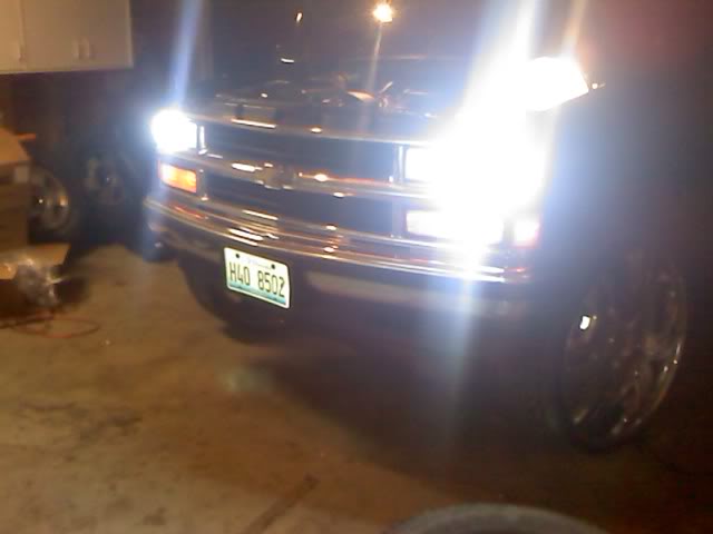

thanks guys ill give it a go again tonite since im installing my wires for the sounds ill just put that on my list of things to do lol
riviera rider
riviera rider
Oct 6, 2009
410
THANK YOU GUYS!!!!!
riviera rider
riviera rider
Oct 6, 2009
410
yes i ****** love them already haha i also took out the daytime running light fuse dont wanna run em all the time
