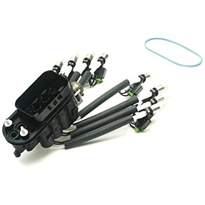

any idea the difference between the AC Delco & Delphi Unit?
http://www.amazon.com/ACDelco-217-3...hevrolet|47&Year=1999|1999&newCar=1&carId=002
