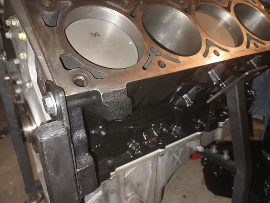

I have an engine block in my garage. I'll take some photos shortly so you can see the water passages and maybe that will help you...

Here you go. Those little "V" looking things on the deck are the coolant passages.
You can also see the Allen head coolant core plugs.
Try to get an inspection mirror so you can see the mating surface between your block and the heads. Maybe it's leaking from there?

@strutaeng Awesome, very helpful. I'm going to run and buy an inspection mirror so I can try and get a better look.
