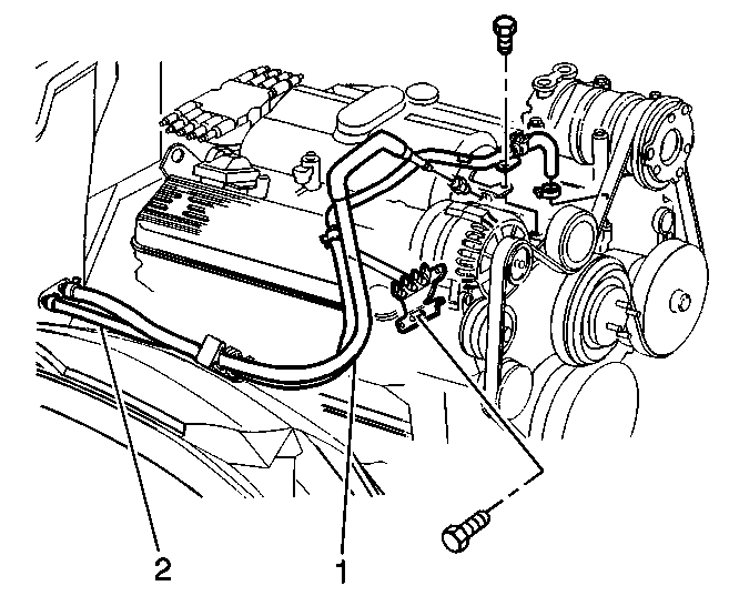

Check the quick disconnect fitting for the heater line at the intake manifold, passenger side. I had one that wasn't seating anymore, and coolant was running all the way back along the rocker cover, down the back of the motor. Took me a long time to diagnose. Get the GM part, not the Dorman if possible.

My apologies. I thought someone was referring to heater hoses coming out of the back of the engine at the firewall.
Yes. I did replace the 3/4" and 5/8" heater hose lines that connect to the heater core at the firewall with new Gates Green stripe hoses. I also put on a new gm genuine heater valve (T). Unfortunately I put on a dorman quick connect...but I don't see any leaks there. All the heater stuff is new...except the heater core (original)...I pulled the carpet back thinking maybe I have a pin hole leak in the heater core...carpet is dry.
Will pressure test it when I get a chance this weekend. Thanks for all the help everyone !!!!
