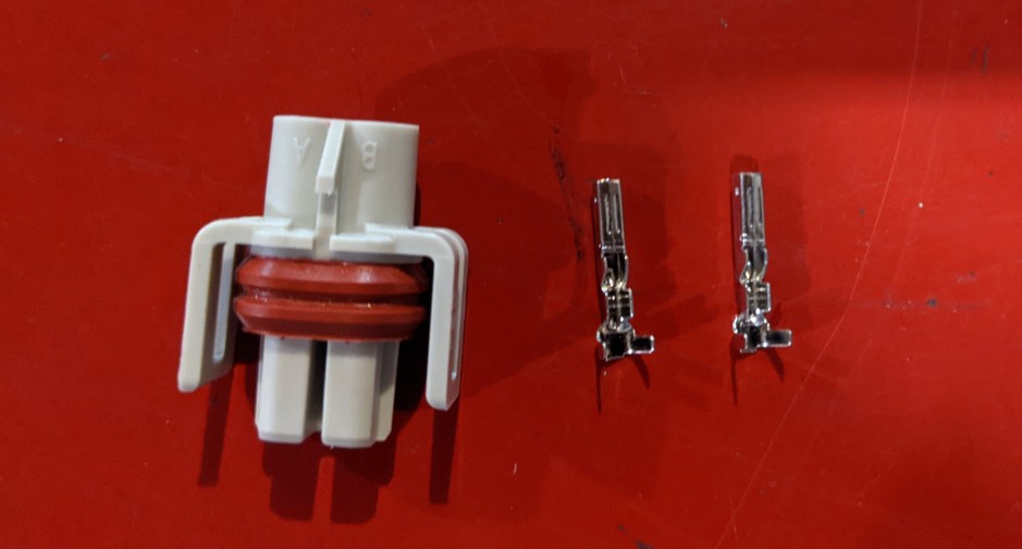

Do you happen to know the part number of this connector and or a pig tail version of it.
I've tried a few junkyards in NoVa to no avail and the ones I've ordered online aren't quite right.
As luck would have it, my second order of a set of electrical connector shells arrived on one day, and the original 'lost' order of a set of electrical connector shells arrived the following day. So, I ended up with 140 electrical connector shells, when I only needed 2. But, at least I had what I needed. I assembled the pigtail assemblies needed for the front struts, using these electrical connector shells and the appropriate contact pins and 16 gauge wire.
I completed the electrical portion of the suspension conversion back to the OEM Z55 specification, and now this project is complete. Another thanks to @TollKeeper for his help in acquiring some of the required electrical connectors at the salvage yard, and thanks to all of the rest of you folks who followed this project and provided input. Very much appreciated.
My understanding is that these electrical connector shells are also used on other parts of the electrical systems for the GMT900 platform. So, if anyone is interested in having spares of these electrical connector shells, and contact pins, just let me know, and I will send them to you for free.
The part number of the connector is shown in the post (see the graphic there) that you quoted. @Joseph Garcia also offers to send connectors to whomever wants a few, since he overstocked.
