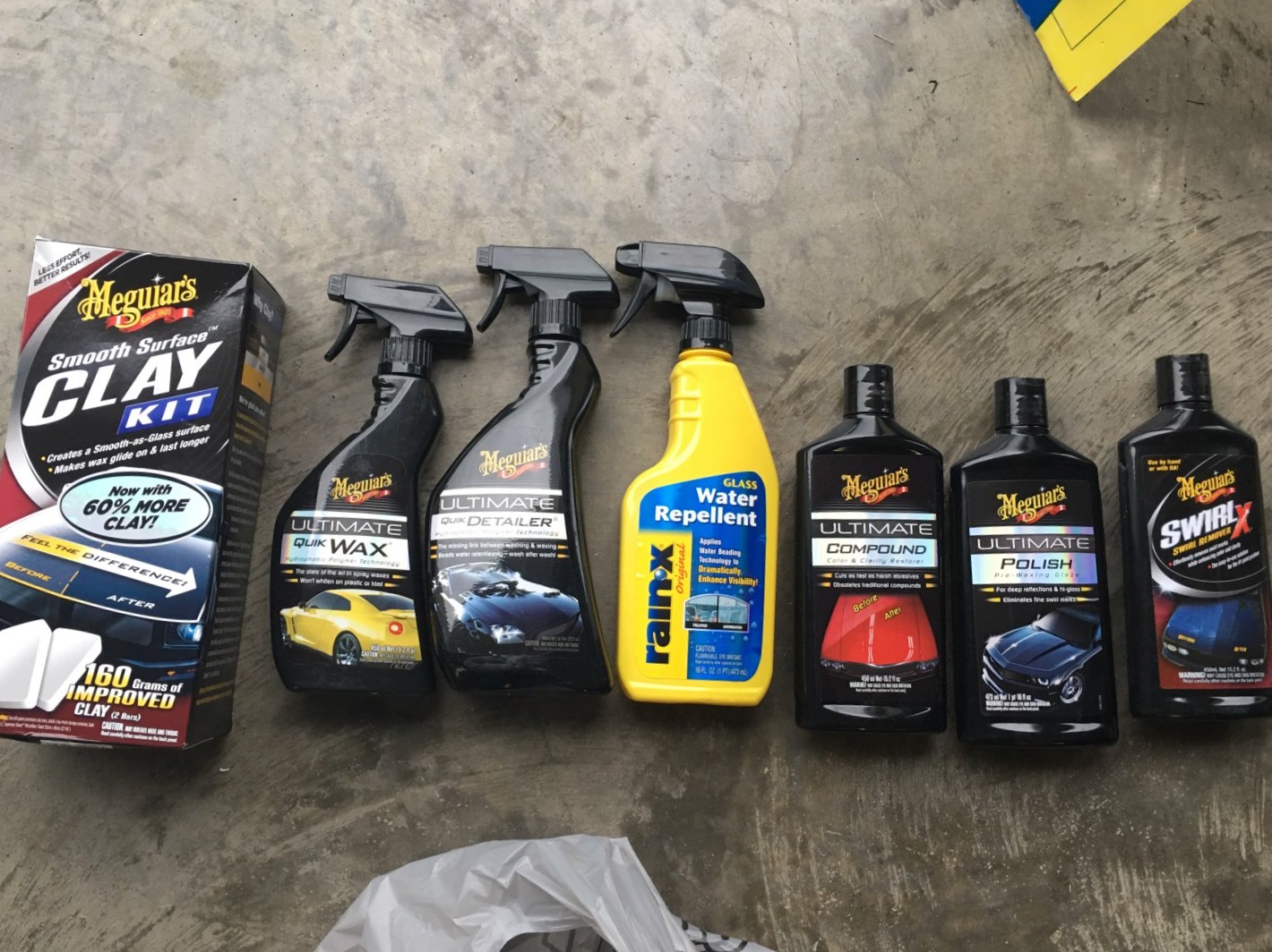

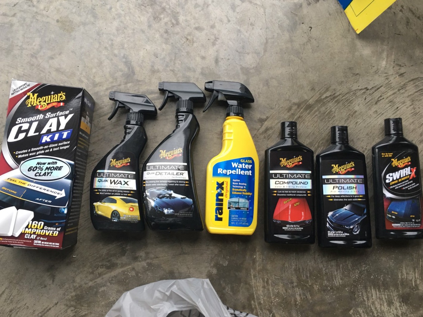

Be sure to keep the clay and body surface wet with the detailer spray and turn/fold the clay often. You'll be amazed at how much crud comes out of the clear coat!
08HoeCD
May 6, 2016
2,052
1,931
THIS^^^^
As long as you keep the paint surface wet/lubricated with the Qwik Detailer, you can just go to town on it. Rub the clay using broad, even strokes with light to moderate pressure. You'll know you're done with a section when you can feel the clay glide easily across the paint with no drag or snags.
After that, hit the paint with another shot of Qwik Detailer and wipe dry with a clean microfiber......or move to either Ultimate Compound or straight to Ultimate Polish. Then wax.
P.S. I have the exact same assortment of Meguiars products. They work great. I prefer Collinite 845 for waxing---it's easy to use and makes paint look wet for months, especially black paint.

Wait till it cools off here in NY you don't want to do this in 90 degrees heat

OIL YOUR ELBOWS!!! They're gonna hurt when you're done, as are your shoulders.
Like was already mentioned, keep the surface and clay wet and turn/knead the clay often. Depending on how much junk you're pulling up off the surface that could mean kneading it every square foot and if you drop it on the dirty ground throw the clay away or you'll be doing more harm than good (use small portions). Claying is ALMOST idiot proof but if you get a big chunk of something in the clay you can scratch the surface of whatever you're working on. Honestly some good practice spots are your windows, they're less prone to scratches than your paint and will help you learn the right technique.

I used the Meguiars kit on mine and was able to do the whole vehicle in about 90 minutes. Like everybody else said, keep it wet and turn the clay. You'll probably end up using both clay bars. If you've never done it before, you will be amazed how smooth the paint will be. Good luck and it's not as bad as it's made out to be.
