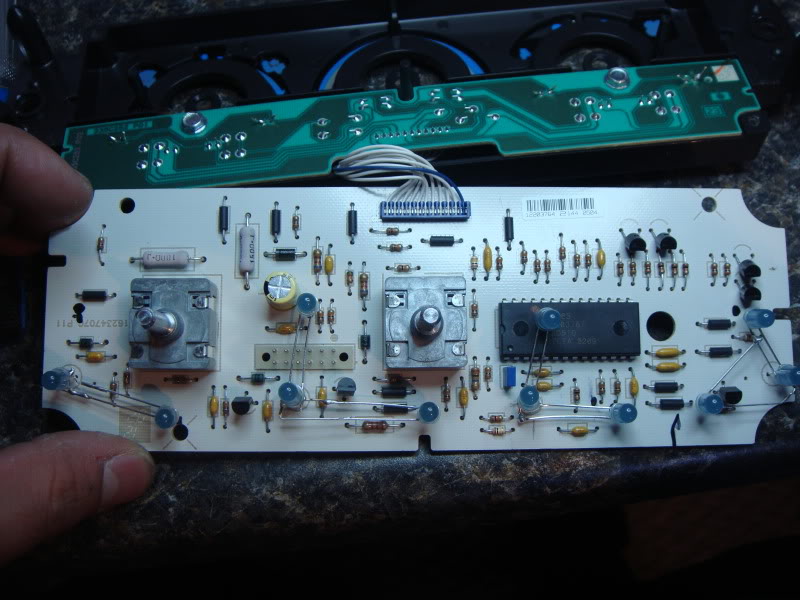

I did this a while ago in mine. I cant remember where i got the leds that i used but they were ones that i didnt need to solder a resister in to make them work. Scrounged up some pics of how i did it. First thing i did was unsolder all the stock bulbs. Also im not great with circuit boards so to figured out which side was positive and negative i had to plug the controls back in and see which way made them work.
This is the board with the nobs on it. As you can see i added a ton more leds because there were too many blind spots where the light wasnt showing.

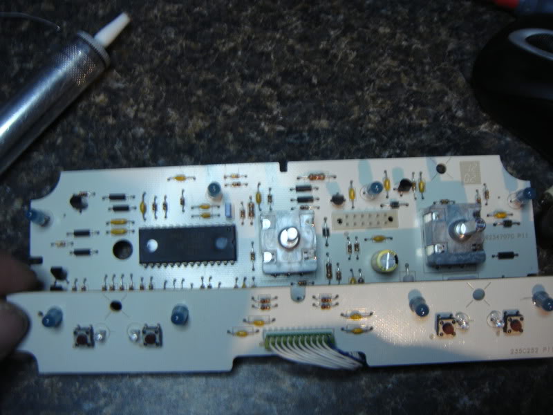

The bottom buttons only need the one led though
And heres them lit up
