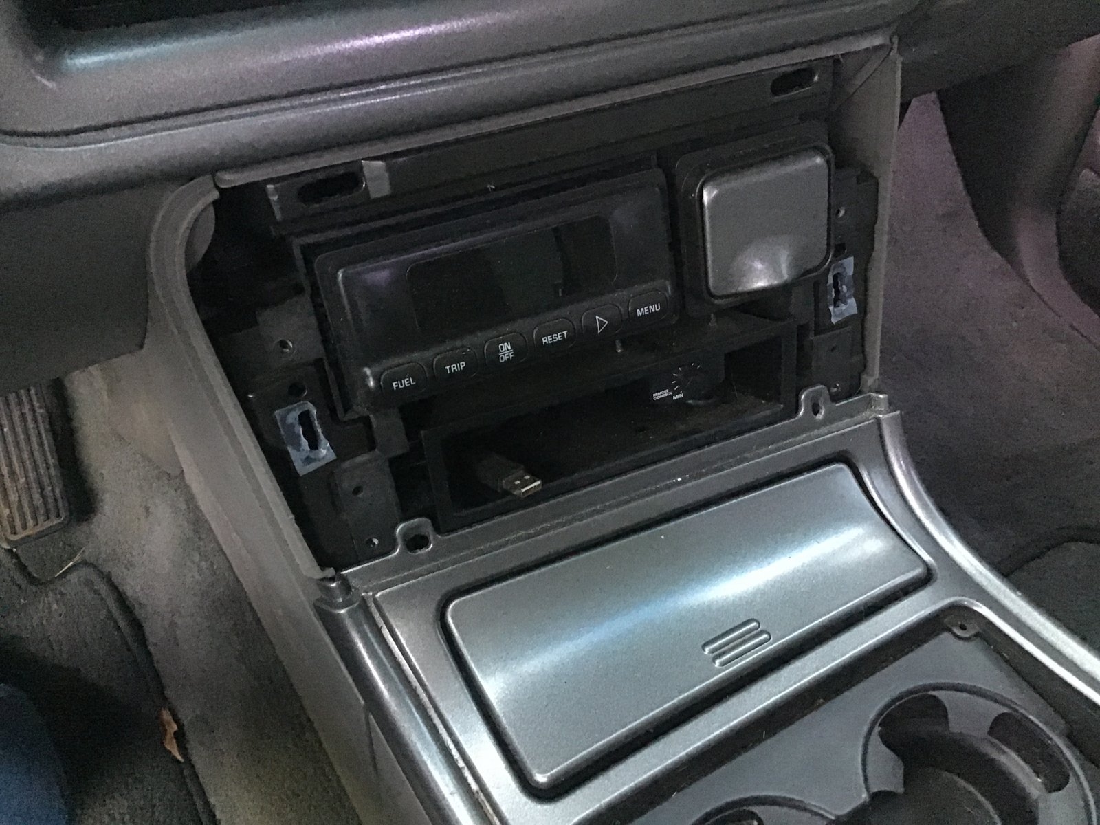

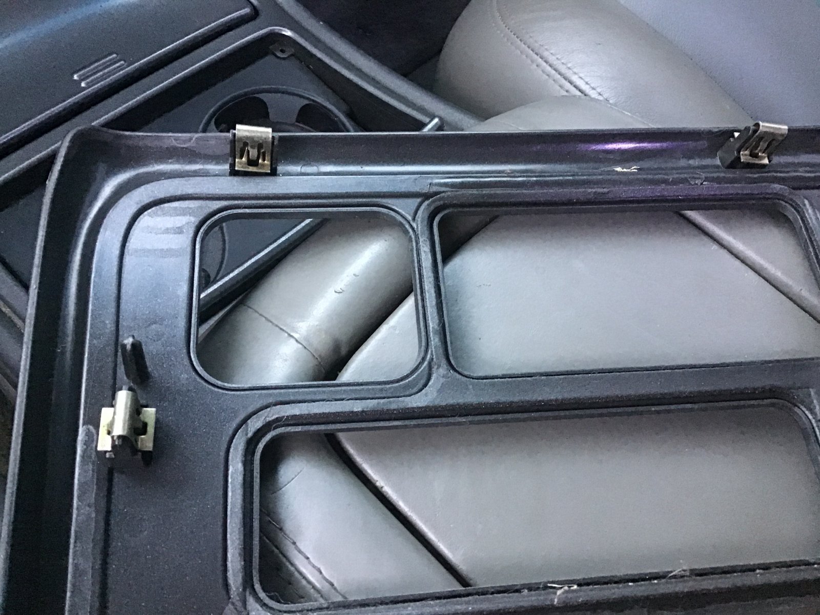

Thanks for the instructions! About the information center and trim. I gave mine a good tug and it didn’t budge. I’m afraid it’s going to snap. You mentioned these are just clips? Just a trim removal tool should do it?
25,529
49,118
Yeah or just pull. Those clips always seem like you’re going to break something, don’t be afraid. They’re all this type of clips.
