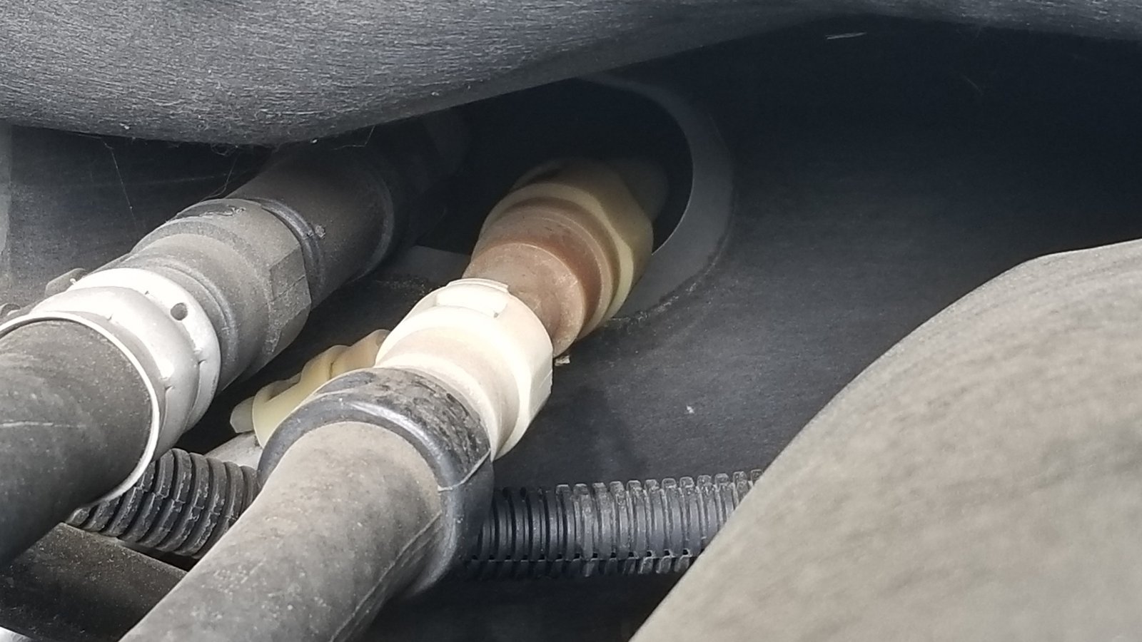

We can smell hot coolant on the '05 Yukon when we get out but I'll be darned if I can find any evidence of a leak. The overflow bottle doesn't even appear to drop in level. Can't smell it inside so that kinda rules out the heater core I guess. Kinda like going to the Dr and then it doesn't hurt. Any ideas from the collective minds?

well coolant tends to flow down so look up from under the vehicle
use a flashlight to see better and a mirror to see under the water pump, inspect all 6 sides of radiator, heater hose t's, reservoir tank.
place cardboard under the vehicle overnight and check for a wet spot in the morning and look up from there.

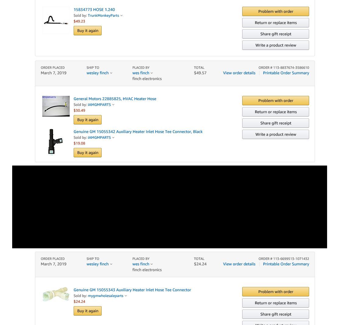

I was going to reply to check the Tees, Wear a pair of gloves when changing out the Tees, as the firewall insulation is quite aggressive, and your hands will itch for the next 2 days.
