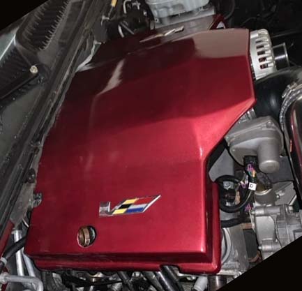

The last bit of dialing in the suspension is done. Now I plan to enjoy this '06 Resto-build as a daily driver and maybe take it to a couple of local car shows. Here is a list of most of the work done:
Resto-Build Details
2006 Cadillac Escalade Base
**Exterior **
-Sport Red Metallic paint correction and ceramic coated
-Mono color accents to grill, running boards and rear bumper
-Cadillac “V” (tribute) badges
-New headlights, fog lights
-Undercarriage/frame detailed and covered with rust inhibitor paint
-Trailer hitch delete
**Suspension**
-Adaptive air ride delete
-Belltech lowering kit with 2” drop spindles, 2” shock extenders, coil springs
-Free travel modification, new bumpstops and front jounce
-New ball joints, sway bar links & bushings, new tie rod ends
-New idler, Pitman arms
-Bilstein shocks/struts
**Brakes, Wheels, Tires**
-2007-2013 Escalade (Gen 3) brake upgrade
-Powerstop slotted rotors
-New power brake booster and master cylinder
-2018 Escalade 20” Wheels
-275/55/20 Michelin Defender tires
**Engine and Engine Accessories**
-LS364/450 GM Performance Engine GM PN:19370163
(LQ9 block with LS3 rectangle port aluminum heads,
LS6 hydraulic roller cam, internal balance, rated at
452HP and 441 lb-ft torque)
-2009-2020 GM manifold PN 12597600
-93mm 4 bolt throttle body
-Fuel rail PN 1262163 and 50lb/hr fuel injectors PN 12609749
-New spark plugs, wires, coils
-New fuel pump
-New Starter, Alternator, A/C compressor and components kit
-New Radiator, electric fan, hoses
-New Battery, drive belt
-New cam, crank, O2 sensors
-Custom engine cover
-Speed Engineering headers
-Custom dual exhausts with Magnaflow muffler and resonators
-Custom tune
**Transmission**
-Stage 2 built transmission, Corvette servo, rated for 500hp
-Tru Cool 40 transmission cooler, hoses
**Interior**
-Custom instrument cluster with 140mph/7000rpm

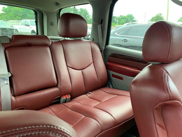

-Deep Red Premium Leather seat kit by Katzkin
-Custom deep red leather arm rests, door trim inserts, center console lid
-Deep Red color accents to dash cover, fascia and center console
-Custom Pewter floor mats with Escalade logo
-Pioneer AVIC8400NEX, 7” in-dash, Navigation AV receiver
-CD changer replaced with custom dual phone charger cubby

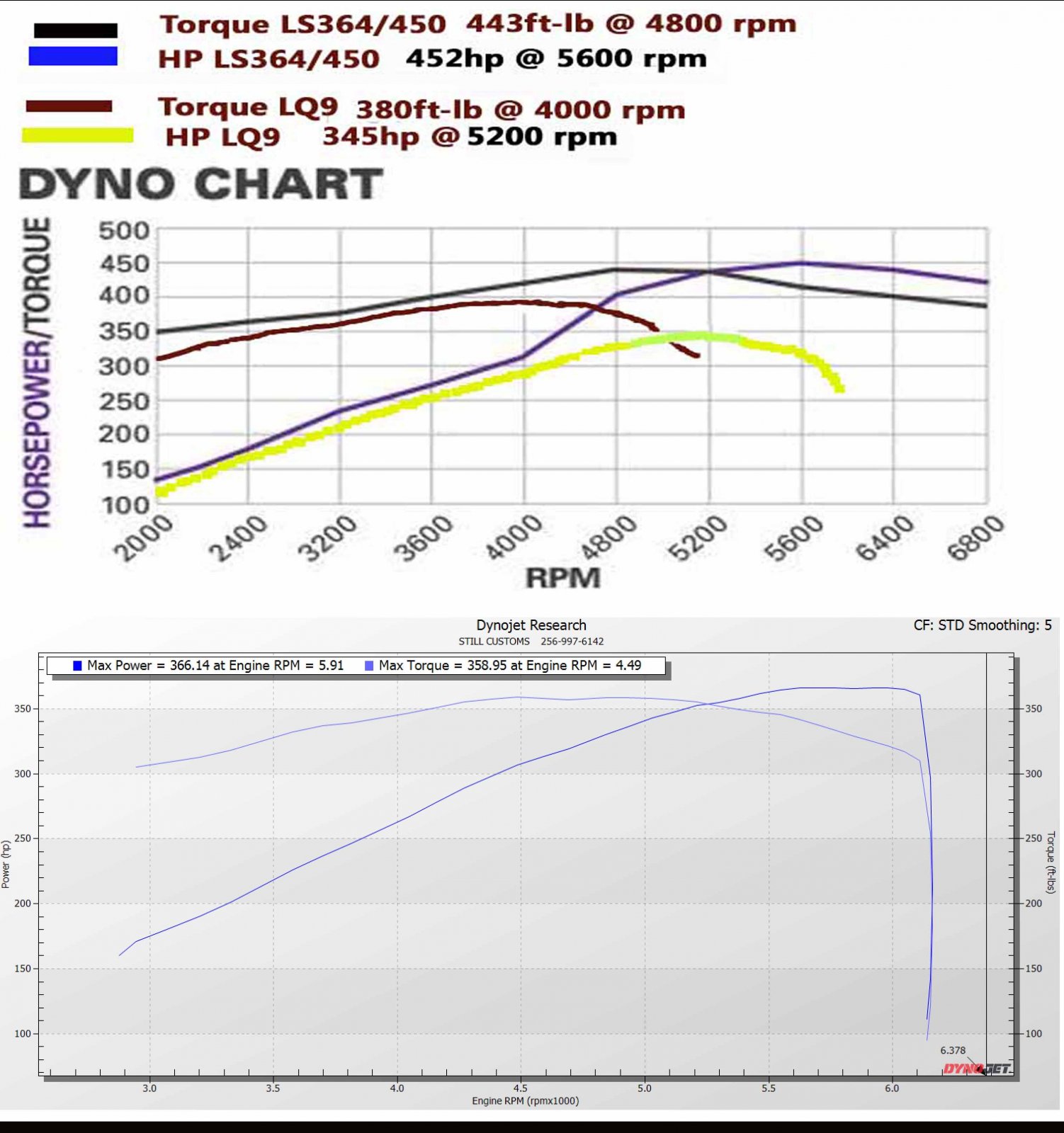

That is sweet... I built up an LQ9 and 4L60E in my setup. Pulls hard but doesn't really accelerate like I thought it would. Will go up about any road though with ease... curious how yours pulls. Have you dyno tested?
