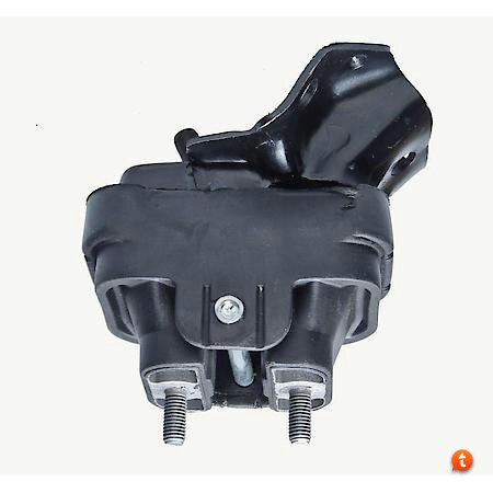

Can anyone suggest where to get an after market mount for drivers side. I saw someone mention Anchor motor mount. Part number?

Thanks Jennifer, I went ahead and just did it myself. Thank you though, it is appreciated.
For those of you with 2WD versions it's not real easy but it's doable by any basic backyard mechanic and you don't have to remove the inner fender well. The hardest part by far was the motor mount to frame bolts. GM used Loctite Red on those bolts so will will need a lot of leverage (and a universal joint adapter) to get those 3 out. The 4 engine-side bolts are easy. When you are lowering the engine down after mounting the new mount to the block you'll need to be underneath and, using a tool (NOT your fingers), help the locator pin get into position as you lower the engine back down. One other thing, if your vehicle uses an Anchor 3211 be sure and use the original locknuts off the old mount to attach the frame mount, not the crappy standard nuts Anchor choose for some stupid reason.
You have to undo the right side Mount bolt as well right?
---------- Post added at 04:17 PM ---------- Previous post was at 04:13 PM ----------
I mean the cross through bolt
