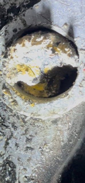

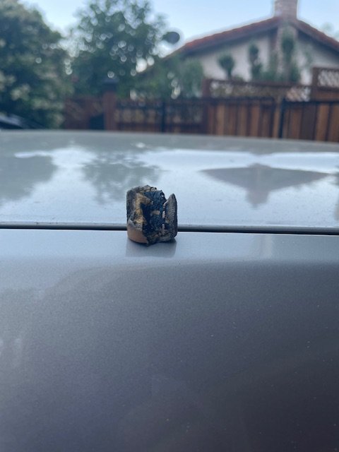

Success!!! With diligence, persistence, pliers and a Spring Hook I was able to extract the sensor today. I drilled a small hole into the side of the sensor before it fell into the timing case and this gave me just enough purchase to grab it with the needle nose pliers and coax it back into the exixt hole. I then was able to get the spring hook behind it and with a little leverage pop the SOB out. New one in is and relearned, hope this solves my camshaft timing problem.
