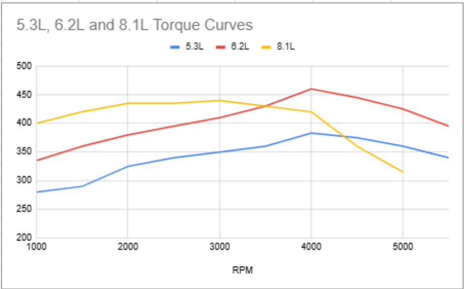

The ONLY reason the 5.3l engines have not seen the same failure rate of the 6.2l is the 5.3l DOES NOT HAVE THE TORQUE OUTPUT THE 6.2l HAS.
I don't think that's the only reason.... we discussed transmission shift characteristics of the 5.3L vs 6.2L. One of these days I'm going to buy another scan tool or pay for a software upgrade on the one I have to have compatibility with our 2024 and plot the trans. shift points on our 2024 w/ the 5.3.
In the lugging regime where many perils exist (high loading, pinging), lets say 1500~2000 RPM, the 6.2L isn't particularly any torque monster by usual big block standards nor is it that much of a delta over 5.3L... especially not if its not running on all cylinders.. I have plotted the torque curves below. Its just that the smart guys who thought DFM was even worth releasing didn't realize it is really BAD to be lugging and also be not operating on all cylinders. (Random guess - Some high up in the R&D team had this cool idea so it made it out..)
PS: I don't care what the horsepower numbers say, but the big block's acceleration and pull for a street vehicle is no joke... Torque down low where it matters. Diesel like... unfortunately horsepower math sells vehicles... so every manufacturer has shifted the torque curve close to 5000 RPM, where it doesn't matter for most street vehicles.

@viven44
Have the dealer change the oil, then pull the drain plug and put what you want in the engine. Hell even the Costco Kirkland Synthetic oil is good and cheap. Again, oil is cheaper than steel.
I am not so worried about Warranty stuff, I am going to pull the transmission valve body on my 2024 with 6k miles and rework it with a decent aftermarket kit probably in the next few weeks time permitting. I have all the parts on hand now. This is a 100% pre-emptive strike for the WHEN not IF valve body problems start.
The 5.3l TCM behaves very differently than the 6.2l, I have a few folks that we have been comparing notes and they are different beasts. While you have the torque curve plotted, understand that the 6.2l is constantly operating in the 70%-100% load range on the highway at slight to medium grades, only downshifting from 10th to 9th gear when it does downshift and this only brings the engine speed up 100 RPM, it is very difficult to feel the 10th to 9th downshift. The 5.3l is jumping from 10th to 8th or 10th to 7th and the engine RPM is jumping up far more and unloading the engine more than the 6.2l.
I agree Torque is KING, I had my share of 500+ ft/lb big blocks back in the day. But while the Torque curve shows approximately 50 ft/lb difference my guess when you load the engine to 100% at 1600 RPM you might see more torque output then running on a dyno for higher RPM horsepower. But the TCM is really controlling the engine torque output these days as the transmission is 100% electronically shifted, so the mapping of the TCM counts quite a bit.
