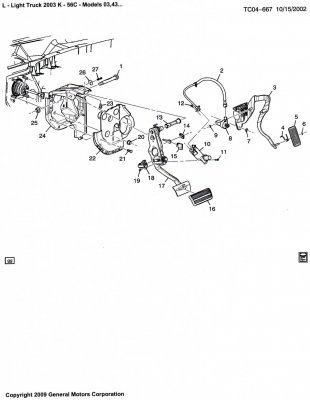

Okay I think I may have gone in the wrong direction a little bit. Probably still something with the suspension, but there is some really good play now in my brake pedal. Just wondering if someone might have a diagram of how the brake pedal is mounted in my yukon. FYI it is the power (movable pedals).

check underneath your dash, follow the brake pedal up, till you see were it connects to the shaft coming thru the firewall. I just went to pepboys, and bought a bushing to replace mine. Alot cheaper then going to the dealership. hope it helps

Wondering if I could get you to tell me which piece you replaced. I have a diagram if I can get it on here. If it is on here is it item 13 or 14?
