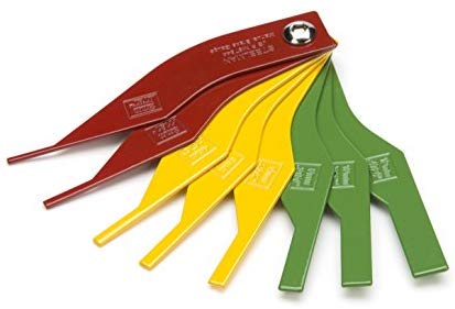

6mm is the largest yellow gauge and 10mm is the middle green gauge. hd pads also tend to be a little thicker and i also like power stop rotors and pads.

new pads are usually all about the same thickness but they can still differ a little. also front pads are usually thicker than the rears but not by much anymore it used to be easily visible. View attachment 2154086mm is the largest yellow gauge and 10mm is the middle green gauge. hd pads also tend to be a little thicker and i also like power stop rotors and pads.
