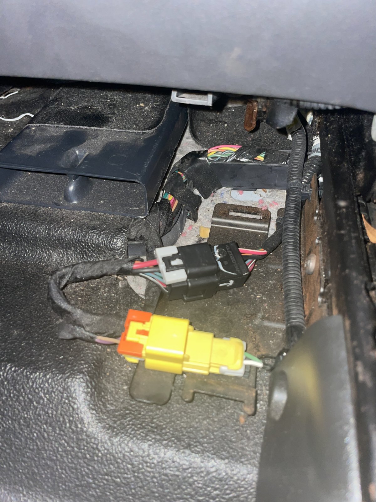

Thanks!!! Good info. I was messing with the yellow one hopefully nothing happened.
I did try sliding out a thin piece of plastic but not sure if that completely takes safety clip off. I tried disconnecting but nothing budged
where the small red arrow is push that little orange tab in the middle and the orange piece will slide off, then once that is off push the yellow tab where the large red arrow is then pull the harness apart, same process for the grey and black one, usually they are tight and may need to be wiggled a lot to separate them.
reassembly is the reverse, push the harness back together then put the little clip on the very end that keeps it from accidentally coming apart.
